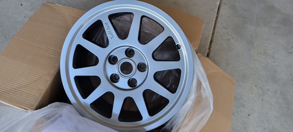

My TuffAnt Kimberley rims (smoked grey) should be arriving tomorrow. I'm pretty stoked, although I'm not in a huge hurry to get the stock 19" rims off my 2013 LR4 since there's plenty of tread left on the Falken Wild Peak AT Trail tires that are on there now. I plan on taking my time and picking the right tires for these 18s and will eventually install a swing-out tire carrier, so placing the tire underneath the vehicle won't be a factor in my decision.
Kimberley Specs:
- Weight: 13.7kg
- Load Rating: 1500kg
- Offset: ET29
- Size: 18" x 8"
One of the five rims came in today and I think it looks great. I need to remain patient and use up the tread on those 19's :)

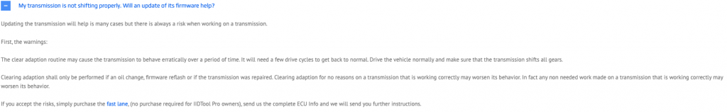

I'm pretty much on the same page with you here. Re-gearing would be amazing for anything bigger than 32"! I'm on 33s too and I found that you can manipulate the gearing software to make it run "better".
I used my Gap IID Tool to change the "Tyre Size MSB - IPC" to 30 and my speedometer was spot on. It's not intuitive where you think setting it to 33 would be 33" tires. Patrick mentioned that it's quite the opposite, moving down from 31 to 30 fixed my issue.
The second part that worked for me was clearing adaptation on the transmission, but it's not for everyone. It will have to relearn all the shifting points, so, the first few drives will have some weird shifting behaviors and you'll just have to deal with it by using slow and steady gas pedal movements. After that, it felt like night/day trying to spin these heavy tires.

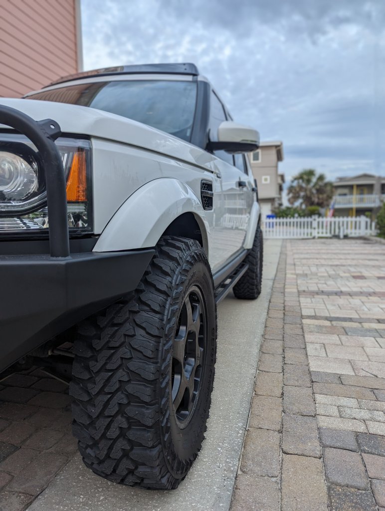

Thanks, I think the Alphas are the best-looking 18" I've seen. I run BFG TA KO2 in LT275/65R18 with about 1" lift on the air suspension from the Gap IID Tool. No spacers, but I did have to cut the frame horns to clear the tires, and trimmed the calipers ever so slightly to fit the 18" wheels (could almost call it a sanding). I went with the BFG for a decent balance of road manners and dry dirt off-roading, but I'm sure something more aggressive would be better for mud. Originally, I didn't want to have to cut the frame horns, but I drove on 31" with stock 19" rims for about a year, and I was constantly obsessing over having something larger. So I eventually bit the bullet and the did the mod and I haven't looked back since.
LOL - Yup, looks like I went down that same path. I opted for the Compomotive 18" wheels (PD1880) and BFG T/A KO2 265/65R18. But, I really wanted to put some 33" shoes on the rig. And like you, I bit the bullet and cut the frame horns and welded in a patch. No looking back now, the deed is done! I am now running M/T Baja Boss A/T 275/65R18.

I feel good about the 280/75/18 geolanders on my compos. Running 30mm spacers and have taken care of any rubbing by dropping the rig to the bump stops and sizing everything. Lots of cutting, grinding, relocating, checking ...all worth it. I also had all the prereqs done for bigger tires so it was just the minor rubbing that I had to fix.
