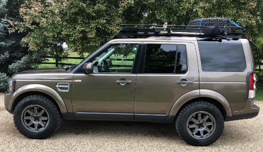

I had a hard time finding decent 19" tire options. Going to either 18" or 20" opens up so many more possibilities, but 18" gives you more sidewall for off-roading. We ultimately went with AlphaEquipt 18" for 2 reasons: 1) I looked the look better than other brands you already mentioned. 2) From my personal experience over the years, from many different cars/trucks, selecting a wheel with factory bore diameter (to match the hub) is important for road manners -- AlphaEquipt also checked that box.

I really prefer the looks of these. Were you able to mount and run them without issue or did you need spacers or to do any modifications? Also what tire did you choose? I’m looking for a tire that would be a good cross between crawling and good for mud.

Thanks, I think the Alphas are the best-looking 18" I've seen. I run BFG TA KO2 in LT275/65R18 with about 1" lift on the air suspension from the Gap IID Tool. No spacers, but I did have to cut the frame horns to clear the tires, and trimmed the calipers ever so slightly to fit the 18" wheels (could almost call it a sanding). I went with the BFG for a decent balance of road manners and dry dirt off-roading, but I'm sure something more aggressive would be better for mud. Originally, I didn't want to have to cut the frame horns, but I drove on 31" with stock 19" rims for about a year, and I was constantly obsessing over having something larger. So I eventually bit the bullet and the did the mod and I haven't looked back since.

Right on. I’ve got the 2.5 lift right now and if I were to get a set of alphas I think maybe getting a small spacer might do well for my application because I would really like to try and run at least 32s. The terrain that I am around the most is generally mud and rock so having something with some good bite is kind of a necessity.
