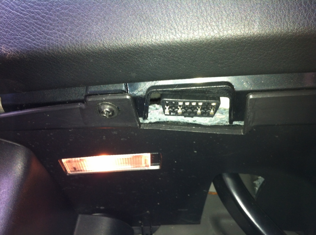

Yep yep I am taking it on Monday. I was just trying to get a round about idea so I'm not going into it completely blind. Does that vehicle have an Obd 2?

Yes, the OBDII connector is under the LH side of the driver's knee panel.
