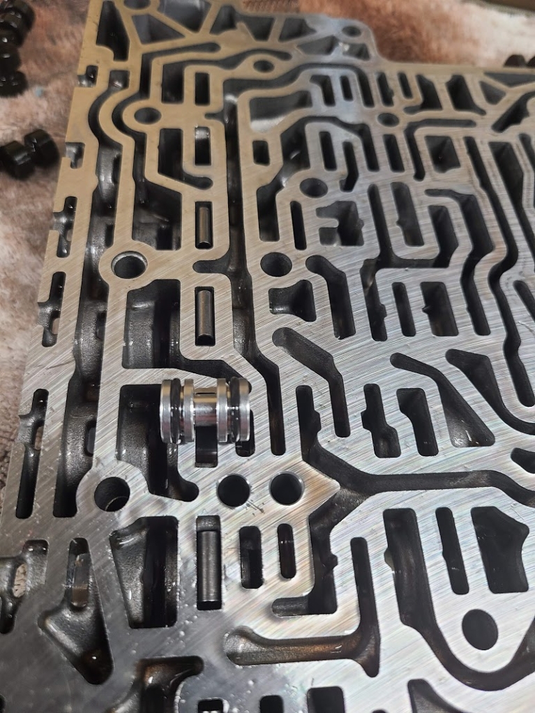

My next issue is that I removed all of the original "part #5" in the zip kit from the valve body and am not sure how far to install the new ones. I feel like I'm really hammering them in, and unsure it its correct.
Any inside if this is the correct depth? New end plug laid in place for reference of how far I'm installing then. It seems to make sense since the retaining clip fits in the groove.

Figured it all out.
Installing a new sleeve was a *****. Probably the most frustrating part.

I remember these going in much much tighter than what came out. Should hold pressure really well. I think you're fine. And yes, that harness had to come out. You're almost there!
Got that. Figured it out a few min after I posted.
