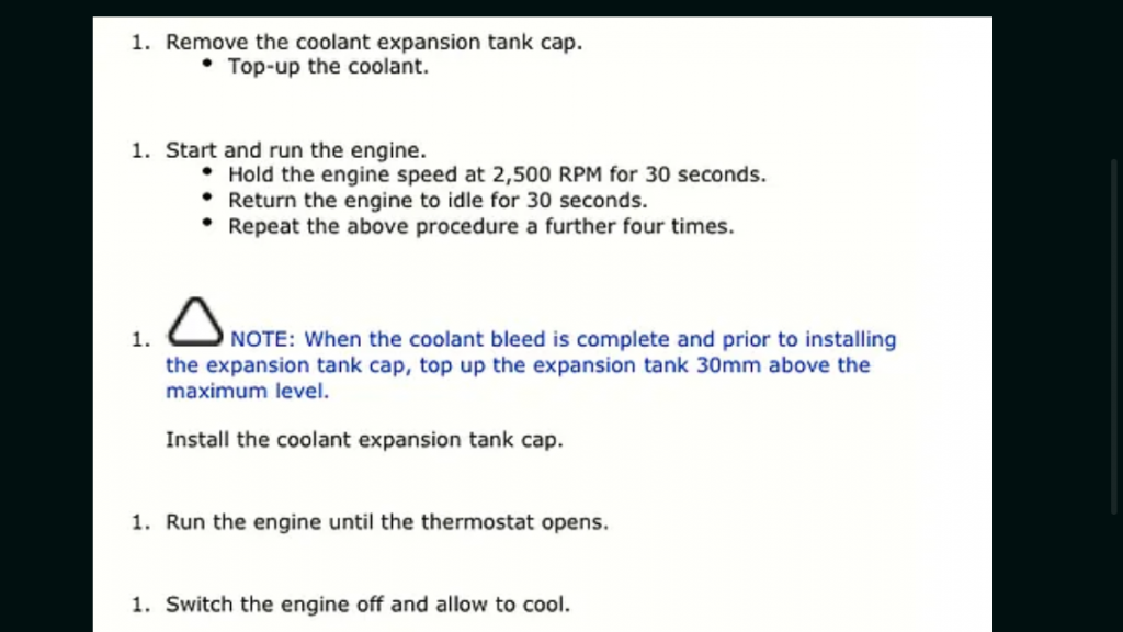

You said the back isn't getting hot here is the LR3 Landrover official procedure, I imagine you use that procedure after bleeding the various lines.
Based on story:
https://expeditionportal.com/forum/threads/lr3-4-rear-ac-line-relocation.143822/page-2
I found a leak originating from the thermostat assembly so I replaced it. Since I am sitting at 160k miles I thought it would be a good idea to change the coolant. After draining the old and flushing the system I filled with new. The problem I am having is I am not getting heat from the rear controls but I am in the front. I found 3 bleeder valves to open at different times during the filling process. The coolant exiting the bleeder valve nearest the battery is hot but the one closest to the overflow tank is cold. Do instructions exist on how to properly replace the coolant and if so could someone please share this with me? I am getting a check engine light illumination and it gives me a code of P0126, Insufficient Coolant Temp For Stable Operation. This has me a little concerned. Thanks in advance!
