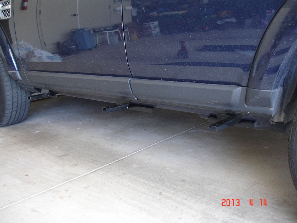

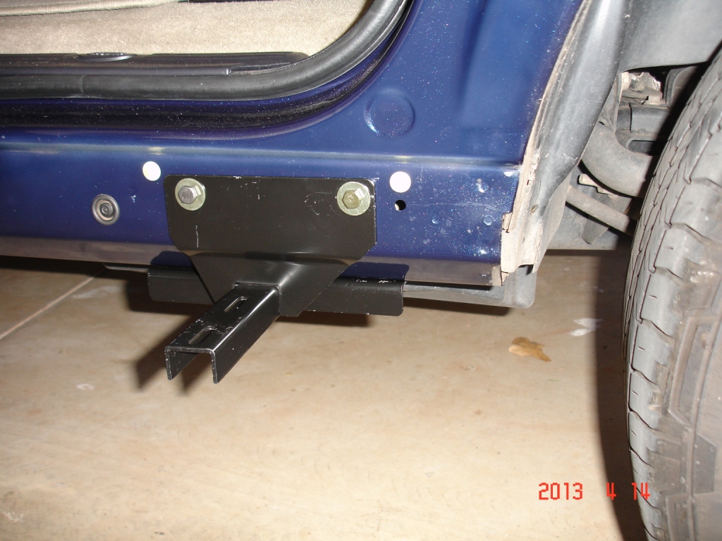

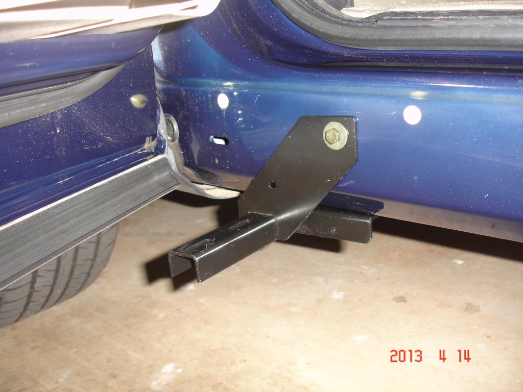

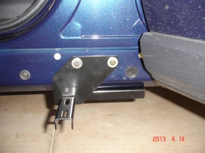

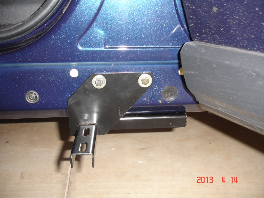

Here are a few photos of the brackets from when I installed side steps on my 2011 LR4. They bolt to existing threaded holes and the steps don't reduce ground clearance. I installed them so my wife could get in and out easier but didn't realize how much I liked them until I had a loaner that didn't have them.

These brackets look different than the brackets in the first post.
My thoughts on increased support for the sliders are those silver blocks that are shown in the OP. I don't remember ever seeing those on my 2014.

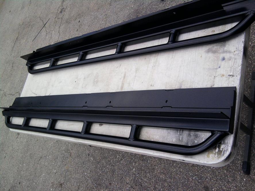

I use the Voyager LR4 slider with steps and couldn't be happier. I think the stock LR step looks terrible and flimsy as hell. I can't fathom how they argue it adds safety. The Voyager ones weigh about 80lb a piece!
Here's some pics of the Voyager sliders (not mine):

I agree with you on the looks of the factory steps. Moms like them at first, in the summer when you give them your first Land Rover but then they say, "in the winter the snow builds up on top and they're a super PITA to deal with when all that stuff is frozen solid!". So then the son has to remove the steps ;)
Those you posted aren't the same model sliders in each photo. Voyager might be on the left, unmounted, but the mounted ones are defunct "Rover Specialties".
I have some and they are not as narrow as the Voyager. The RS are about 14" deep along the middle and then even deeper at the ends in an angular shape to follow the frame rails underneath. Also, the RS are exactly 100lbs each side.
The top/mounting side, RS, look nothing like those unmounted ones either.
