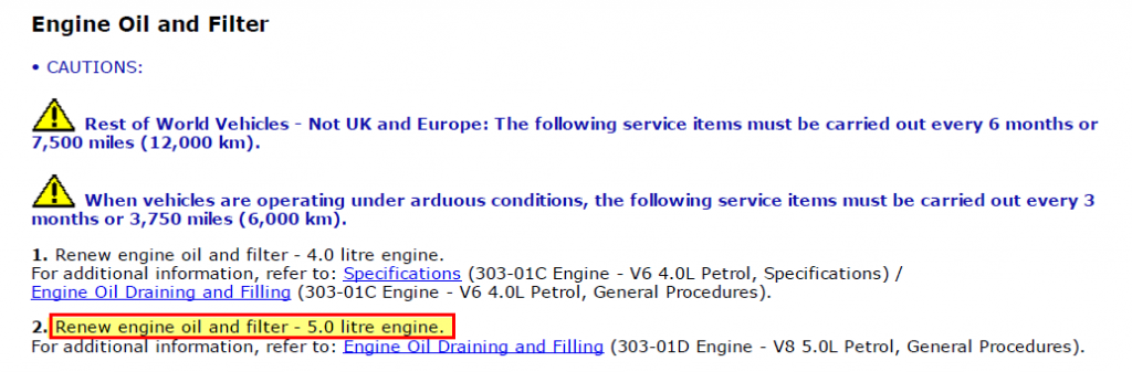

gsxr
May 8, 2017
811
416
Big Sky Country
That is crazy!
Soccermom = 16kmi (!)
Armored vehicle = 6kmi
Arduous usage = 4kmi
Seems like a yuge gap between those numbers.
:dontknow:
