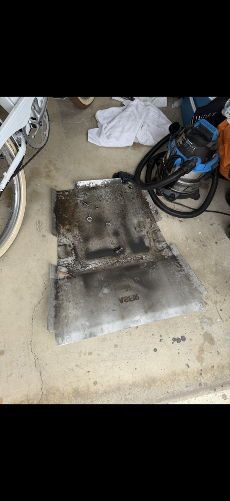

I do 5k oil intervals. Pulled out about a liter less on this oil change, around 7.5 liters at 154k. My car leaks it, doesn’t burn it. My rear main and upper timing cover and valve covers leak. I’ve been lazy abt the upper timing cover because if I have to pull the valve covers then I might as well do the chains too which is something I’m not totally confident I can do myself.
As far as the way I drive it, I beat on it a little under the right conditions. Oil has to be above 170 before I really go over 3k rpms and I probably see redline 1-2 times a week.
This was a picture of my skid plate after 10k miles and and less frequent driving over the past year and a half. My alternator died at 147k last year and I think it was from my upper timing cover leak putting oil into it but could’ve been old age too.
