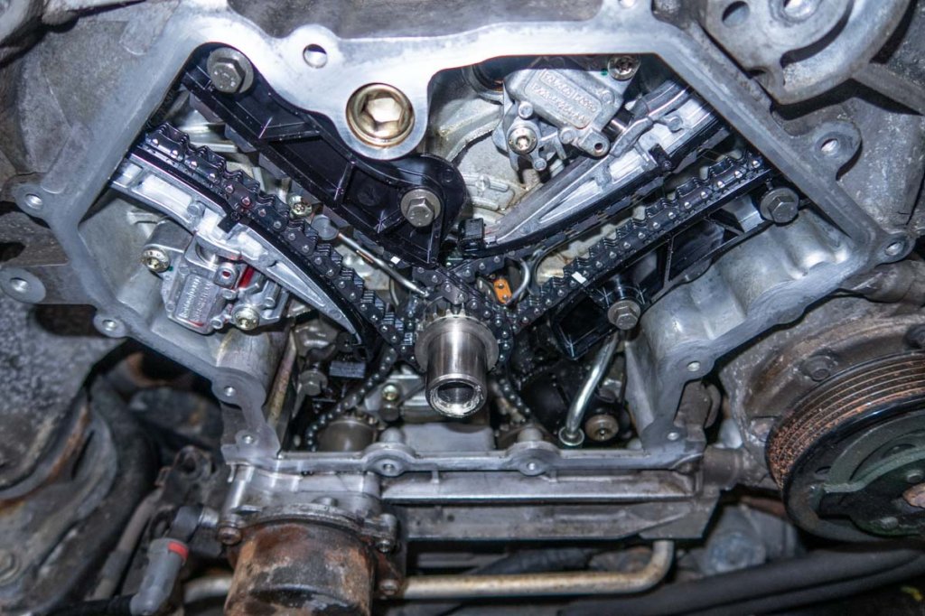

You are right the 2010 engine has a different block from the 2009 style. It has a new number but is clearly a derivative of the first. We rebuild them steadily and from that vantage point (taking them apart) they are newer and older members of a family, not unrelated products. However that is not the point of my original comment, which was that these engines don't have sludge problems when the right oil is used, and they don't need or benefit from 3k oil changes.
As for the question about Ford heritage . . . you will see Ford logos on the timing chain pieces and other internal parts if you take these motors apart. Both this motor and the original have significant Ford influence even as the final implementation is Land Rover. The photo below shows a 2013 engine with Ford logos visible inside the timing cover. In this same photo, if you are familiar with the earlier motor (2005-2009 in LR, 1999-2009 in Jaguar) you'll note the timing chains are all different, and these have proven to be the weak point in this motor, hence my comment on the shearing of oil, not sludge breakdown, as the problem.
What that means is that it's most critical to use oil of the right grade and change before shearing starts to happen; hence my suggestion that 7500 is safer than 10000 which is known to cause problems. 3000 is not necessary and won't provide additional benefit.
John, if you don't mind a tangential question, what is your take on the idea that late 2012-and-on LR4's had the issue corrected? At first we believed (hoped?) that such cars would be immune thanks to a revised part with an insert that would prevent the wear point, but we have heard some instances where cars beyond that production date have had issues.

Quijote, the engine in the photo is a newer motor, and it had chain troubles. I think these problems persisted into 2015 and possibly beyond. It's hard to say because the motors are not old enough yet. We thought the Bosch motor in the MY 2000 Discovery was a huge improvement and it took a number of years to discover the engines failed from improper oil gallery drillings and poorly fitted liners (a product of worn out tooling, most likely).
I would be wary of any of these engines as they approach 100k miles. I tell people, don't buy one of these if a $10k engine repair will cause you undue stress. With some cars, that kind of expense goes with the territory. Anyone who buys a new Autobiography for $140k should be able to handle it, but the buyer of a $10k secondhand LR4 may be in a different situation
