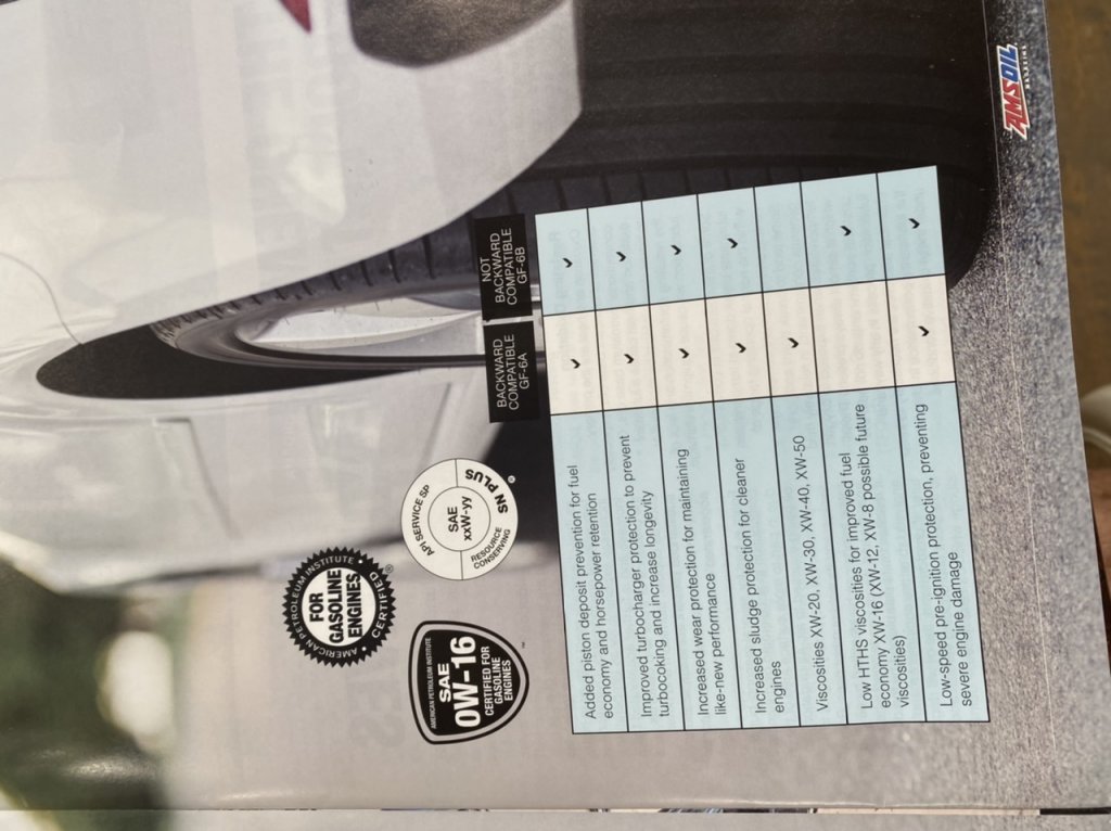

The Amsoil magazine has this article which may be of interest. 1549DA65-6DF4-4005-B16B-45DCA571DD08.jpeg 733C4296-1CD9-4EA7-951D-C9FADA636903.jpeg

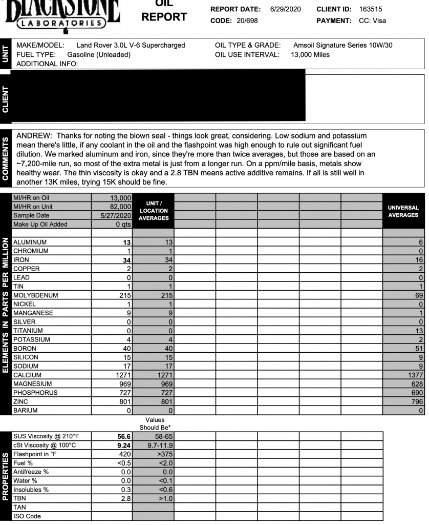

Got my black stone labs report back. Other than the oil type (which they typo’d or I wrote wrong by accident) everything looks great. The viscosity is thinner than the “should be values” because those are for 10w-30. this is a 13k + interval with heavy city driving and a blown supercharger in the middle of it. I’m pretty much fine to increase to 15k mile intervals which is amazing given my driving style.Screen Shot 2020-06-29 at 5.47.40 PM.png
Fuji4
Jul 26, 2014
505
240
This next year, i will cross the 15k mile barrier because ski season will ?happen? and ill log some long trips. Ill do another report in a year and see how it goes. It is what i expected, based on my knowledge of amsoil and watching other people on youtube, etc. But it is nice to get the actual results back.

It will work fine with Mobile1 also… The only way to get a really crappy report is to use non-synthetic oil and don’t change it for 15,000 miles...Are use them as oil for about 10 years and then switched back to mobile one… For daily driving you’ll never notice a difference
gsxr
May 8, 2017
806
415
Big Sky Country
Not all synthetics are the same. For standard drain intervals, the difference doesn't matter. But when you are pushing to 15k or beyond, it does matter.
