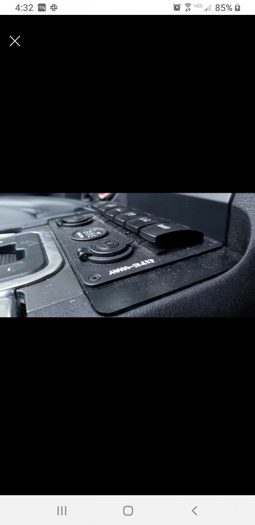

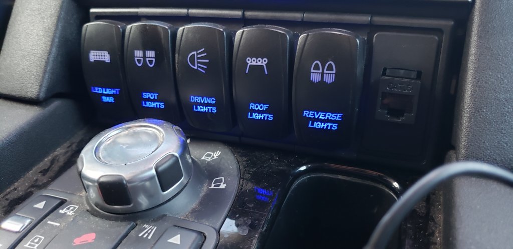

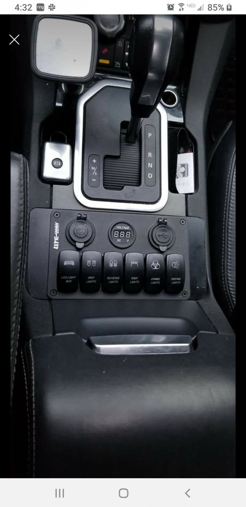

I did this on my '11 LR4 where it replaces the ash tray. The rj45 port is for my ham radio mic.
View attachment 12483 View attachment 12484
My old setup.
That is slick. Did you fab up the plate to replace the ashtray yourself, or did you find a off-the-shelf item that fits?

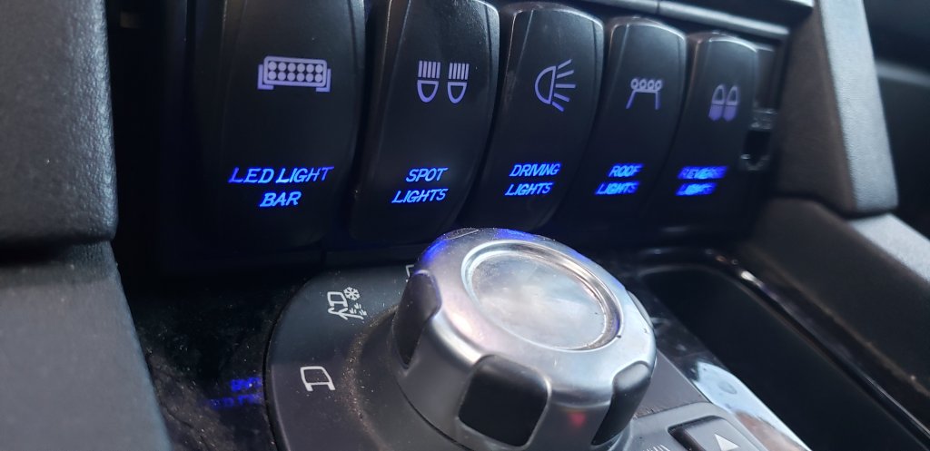

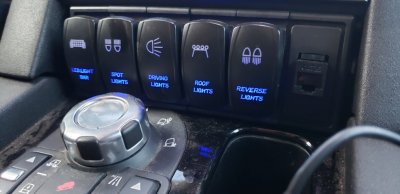

I got a 6 gang rocker switch panel from amazon and made a few modification cuts in the back to make it fit. Since all my lights are external, I used Cat6 ethernet cable through the LH firewall to individual relay switches to power the lights. Basically, the Cat6 cable is just a signal wire to the relays that provide the actual (positive) power feed.
I also tapped the cigarette plug for the rocker switch illumination. So that the rocker lights will light up with the ignition.
