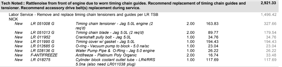

Cherry Hill Land Rover NJ quoted $4,050.00 complete tensioner/guides, chain install.
thats absurdly low for a dealer price! almost want to say they've misquoted in. all other dealers are $7500+
way to go if its accurate!

JC's British 4x4 an indy shop in Denver quoted me $2,900 to fix. No new chains. Just new tensioners and guides. Hate to see it, but far cheaper than a dealer repair. I'm at 140k in my 2011.
