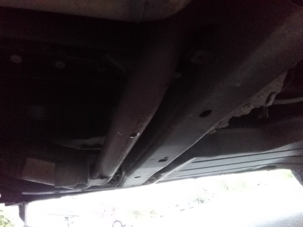

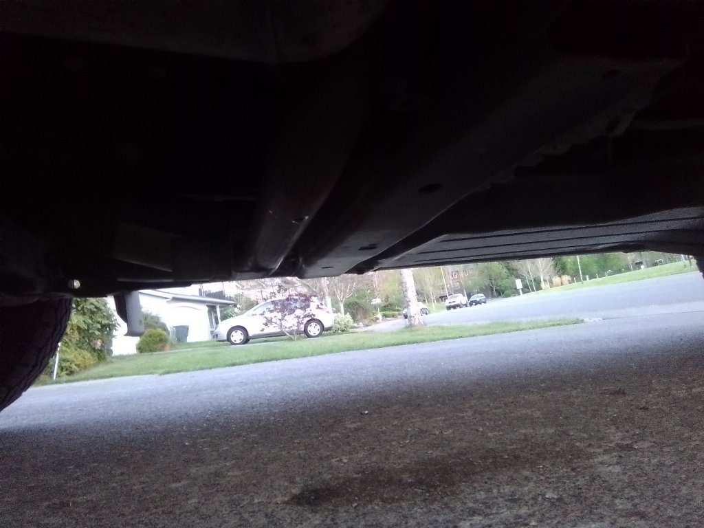

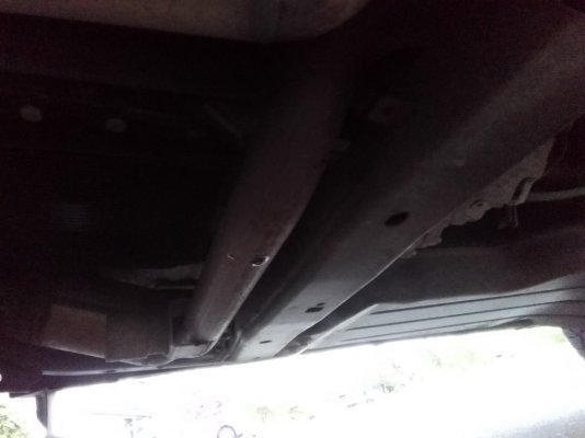

I just got my A/C recharged and now I noticed a small puddle of water in my driveway. It's water. Not coolant, not oil, plain water. I took a bit of toilet paper and let it drip onto it. No smell. No color. No oiliness. Could this be from a drain pipe?
In the pics below, you can see a drop of water on the pipe, but it is dropping from above, hitting the pipe, rolling down the side, forming a drop and then falling to the inclined driveway. By the way, it has stopped now.

Update: Whatever it is, seems to be a non-issue. Rig is running fine and I don't see any more water puddles underneath. I just don't know where the A/C condenser is supposed to drain. If that's the right location, then it looks like it is just another false alarm.
Perfectly normal.
