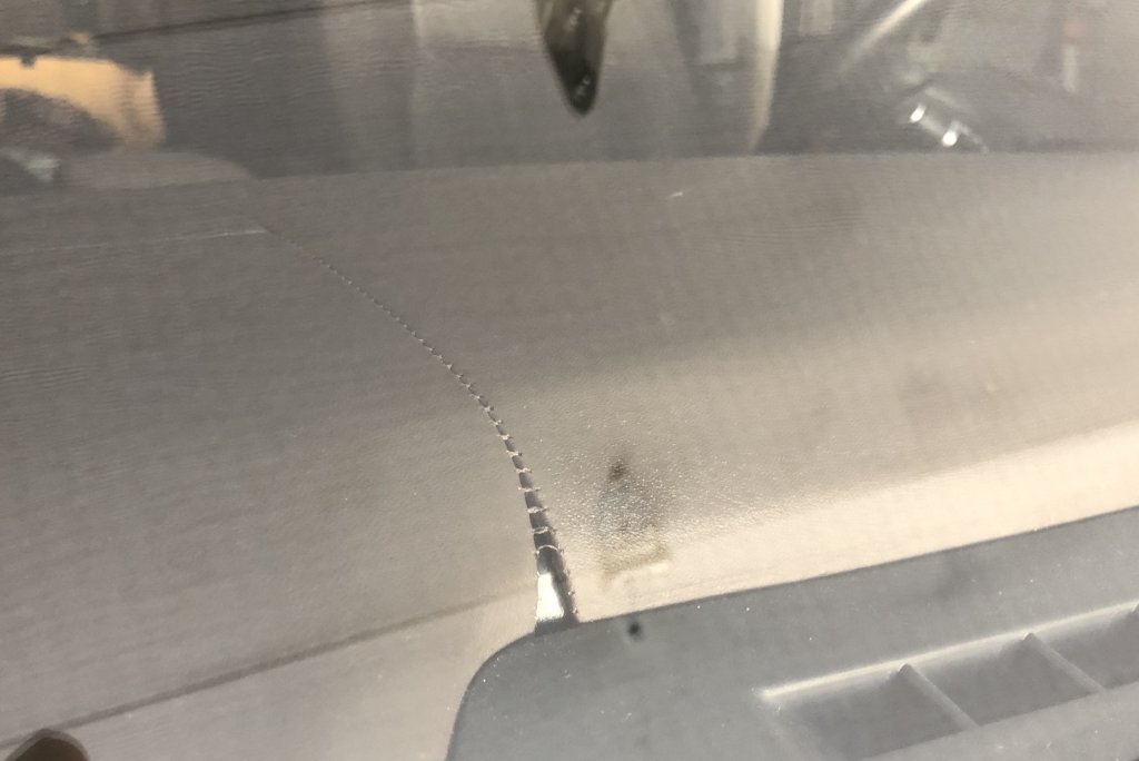

I've got the lux package as well and just noticed this is happening. I didn't notice this last wash
so it's recent. In the records from the dealership in Florida where I purchased mine it says the dash
was pulled at some point. Any idea what the response will be if I try to fix it under CPO?
Anyone had this happen? Seems surprising on a 5 year old car. It's happening in 3 places.
I don't know what the response will be but I would not hesitate for a second to pursue coverage through CPO. If it was a dealership that pulled the dash then I would also question the quality of the repair. Seems like you have some good facts to work with or can at least make a good case for CPO coverage. My .02...

Based on the research I have done, the lux package does not change the dash material, the extended leather package does. Do you have a leather wrapped dash binnacle (the thing that is a good over your gauges) and the upper door area? You’ll see the stitches as a giveaway.
If you have the extended leather package, then you are like me. The parts guys I’ve talked to says they see this issue a lot on outside southern cars.
Take a deep dive into your CPO paperwork. See if it covered interior stuff.

Yes,my mistake, I think I assumed lux came with extended leather. But right, I have the extended leather. I’ll check tomorrow and see what happens.

If it is, I just wasted my effort and money on a replacement. I bet it’s southern heat kind of thing. Thinking of getting the windshield “tinted” with that ceramic stuff they have now, using a UV blocker product on the leather and throwing up a sun shade when I can’t park under cover.
