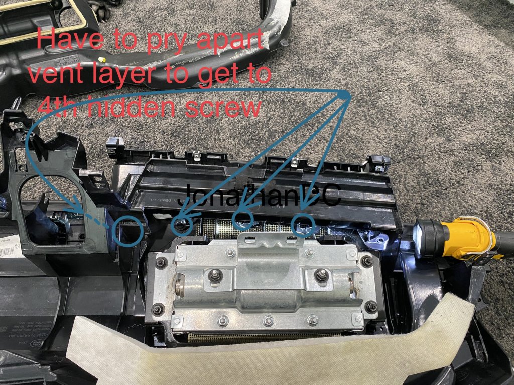

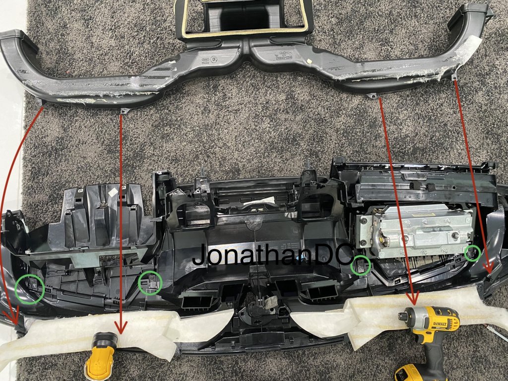

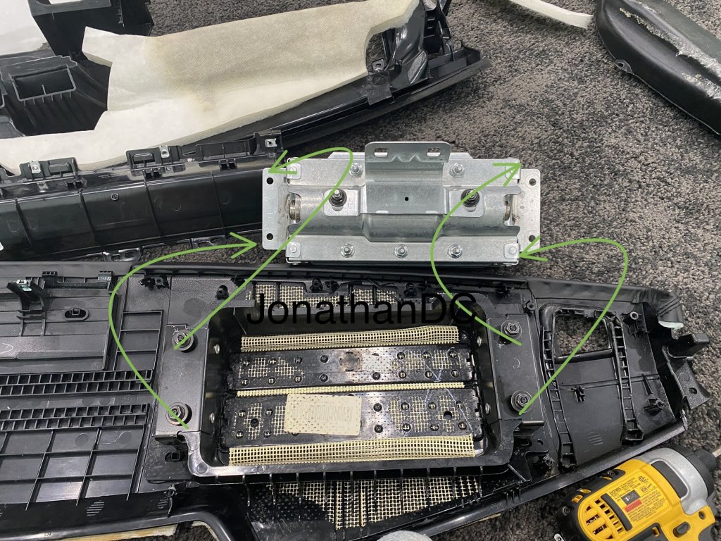

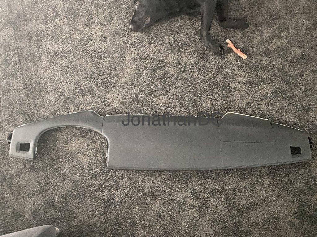

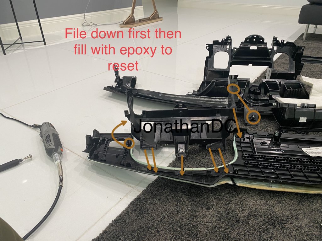

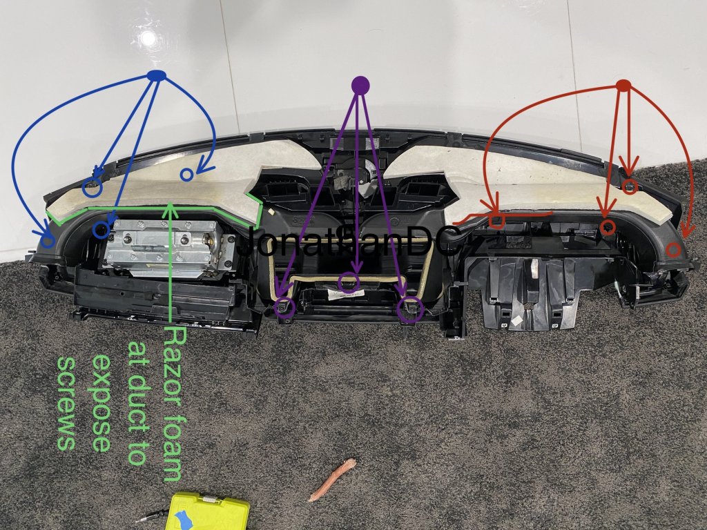

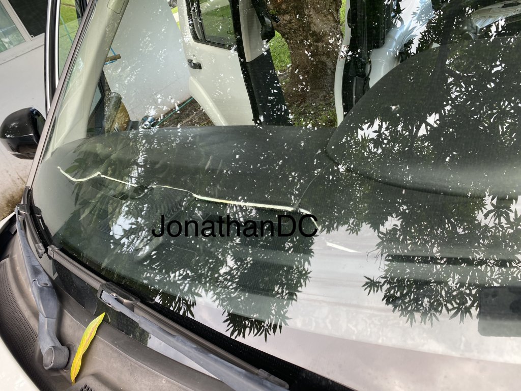

Sliding out the dashboard wasn’t the easiest for my 2014 LR4 (a weekend job), but it is possibleand not $4000…just patience along with some gloves, T30, T25, T20, 10mm, Philips Head, flashlight, flexible drill extension, razor blade, decent magnet, & trim tools (stiff plastic). No issue with the airbag…only 3 connectors you slide out/disconnect but the first thing I did was disconnect both batteries so I never was worried. More pictures on the post below this one—

Reviving a dead thread, sorry.
I have this issue as well on my 2014.
Dealership wants $4k to replace. I had conversations with LR USA for months trying to get them to pay for it and all they did was offer a discount on the part.
I talked to an independent auto upholstery shop and they didn't want to touch it given liability for messing up the passenger side air bag deployment.
Uploaded w/a few pictures of it done including message above yours after realizing no one has stripped it down to just the offending part. Rest of the pictures are above this message

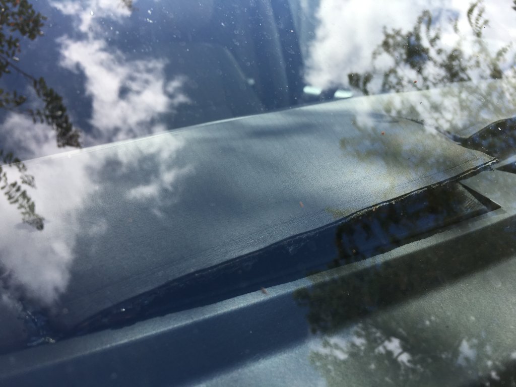

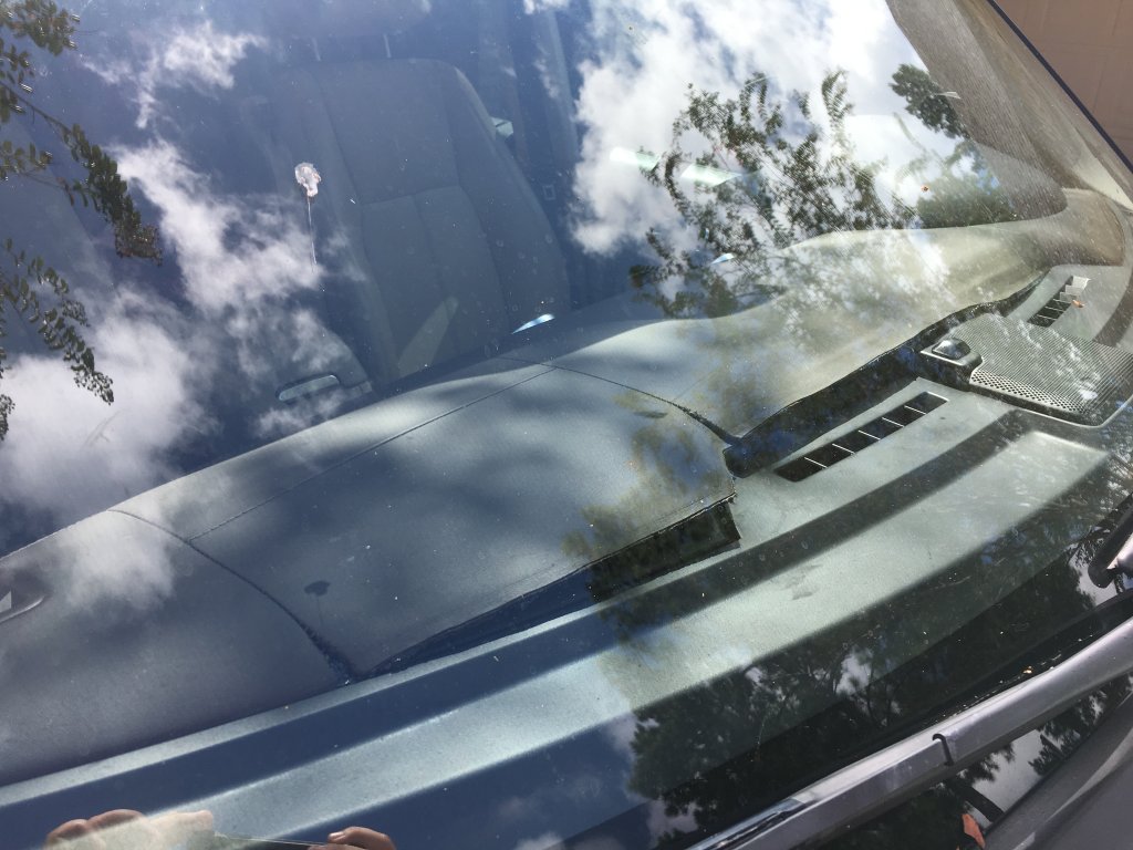

Anyone have a solution for this? First day out in the parking lot at work, and it has gotten very bad. I’d like to fix it but a used upper dash is $500, and looks to be a nightmare to get it out. View attachment 8395 View attachment 8396
