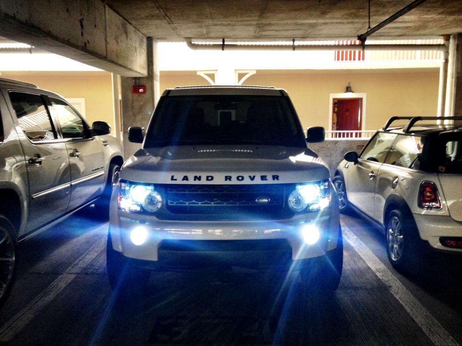

HID 6000k fogs installed. There's more room back there than it first seems. I shoved the ballasts behind the fog light housing on both sides with no issues. The drivers side seemed better because it was more "wedged" in there, which I felt good about. On the passenger side, there's nothing to really wedge the ballast into, so I hope it doesn't bounce around and become loose. I'll keep everyone posted on that, but it doesn't seem like it will be an issue. I am much happier with the color and brightness of these compared to the Philips CV's. Installation took about 10-15 minutes on each side, and I am far from an expert. After doing the headlights, I must admit, it was a LOT easier.
