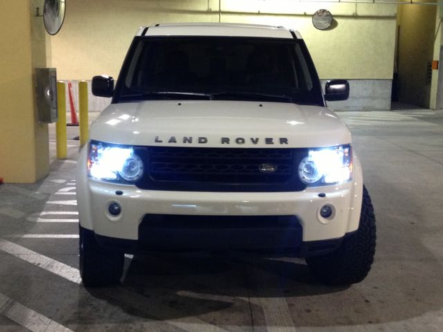

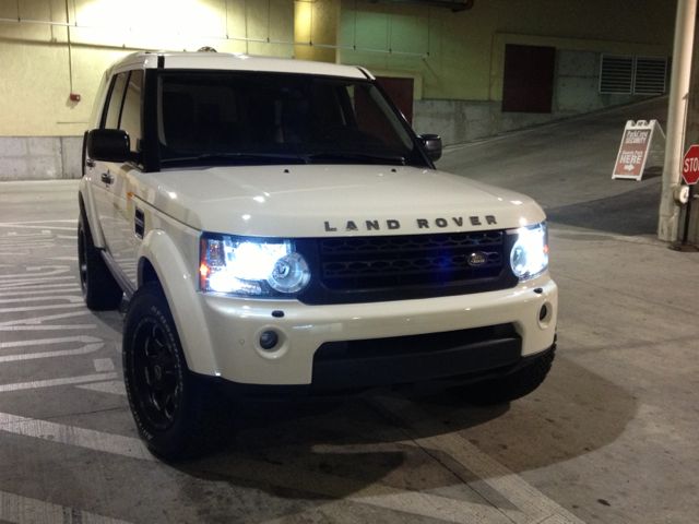

Here's a few quick shots of my low beams installed...

Looks awesome!
I think you should definitely try to install the HIDS in the fogs - would look sweet. I tried it a bit, but could not figure out where to put the damn ballast.
