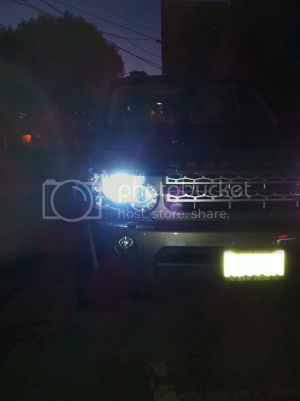

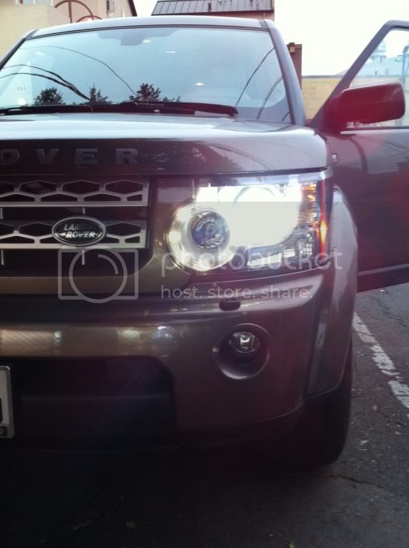

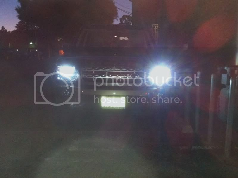

I do not have a picture handy against a wall, but these are from 2 years ago when I first installed the lights - lots of updates since then. The pictures do not do the lights justice, but can give you a general idea:

Thanks for the additional pictures, can't wait to get 'em installed!
95
They make a world of difference and look pretty awesome. It's hard to tell from the photos, but it's a very crisp white/bluish tint light and looks pretty OEM.
