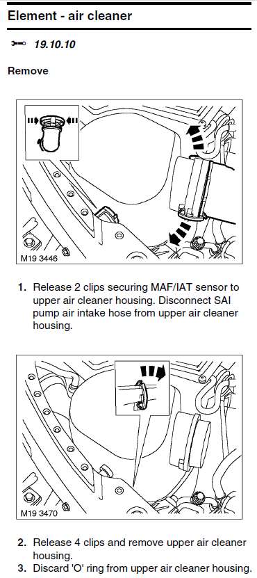

I recently bought a used 2006 Range Rover Supercharger and the dealership said it was going to cost $80 to replace the air filter. I've found them online for around $32+ and just need to find out where the air filter is actually located. The engine compartment seems pretty "covered up" everything is under shrouds or covers and I didn't want to just start taking off the various covers to find the air filter. I've search online for pics/diagrams/manuals but no luck! Any help would be greatly appreciated!!
