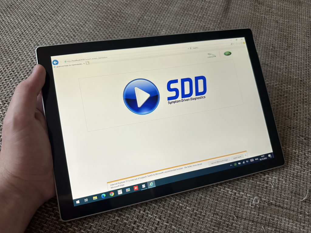

My only issue with the JLR Mongoose with SDD software is finding a dedicated Windows XP or Windows 7 OS, the last time I checked back in 2016. I wonder if they developed/support the latest Microsoft OS versions.
It's works fine (162.00) on win 10 with my Surface Pro 5, just need to use IE compatibility mode for EDGE

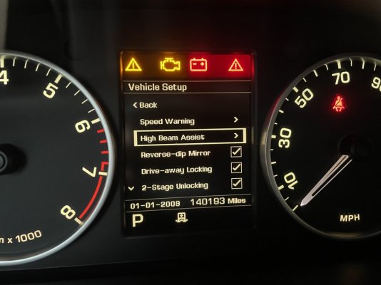

Yep, use it with my 13 LR4. Already retrofit High Beam Assistant and ACC, next will be paddle shifters

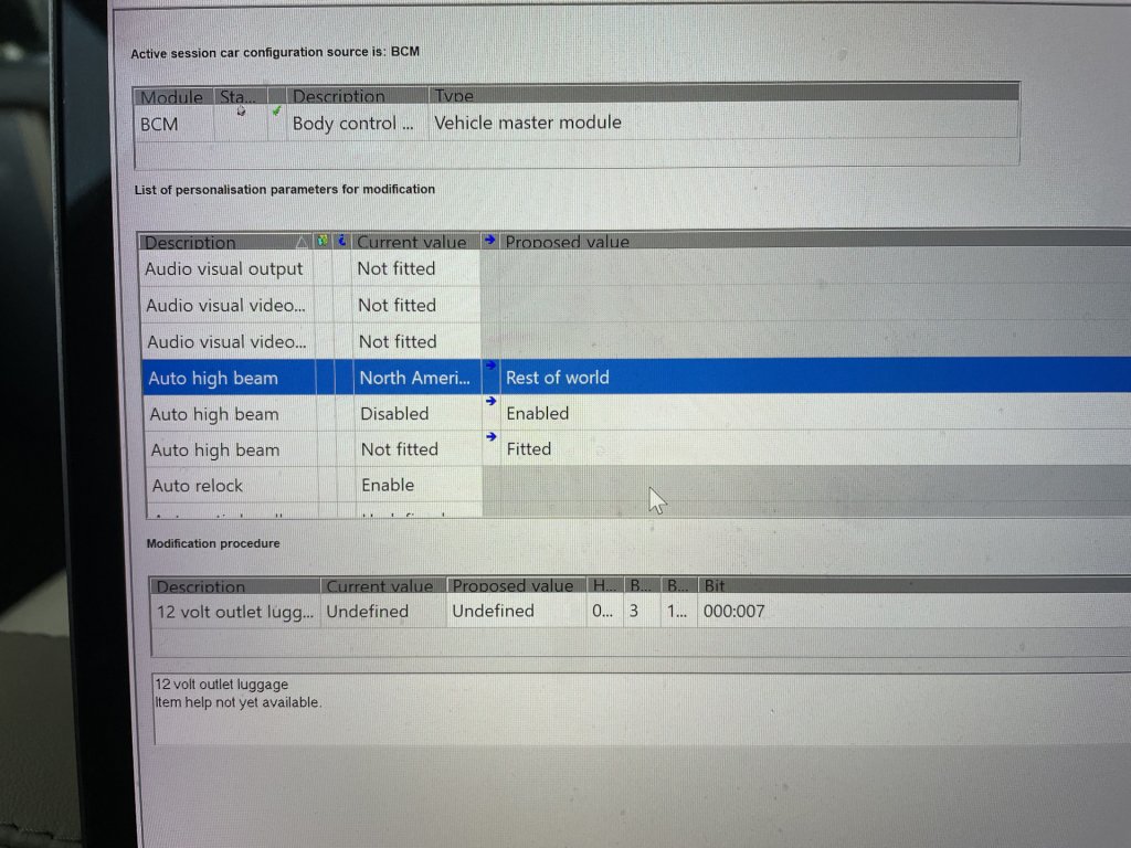

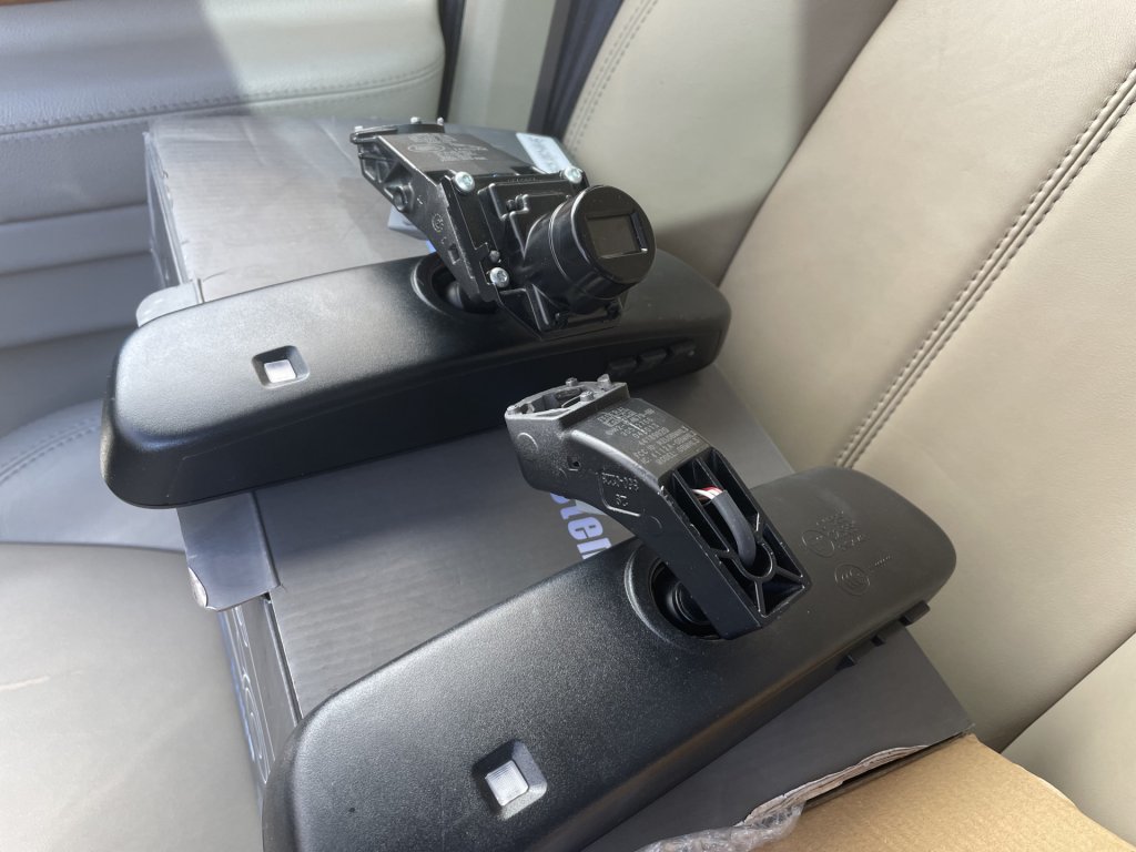

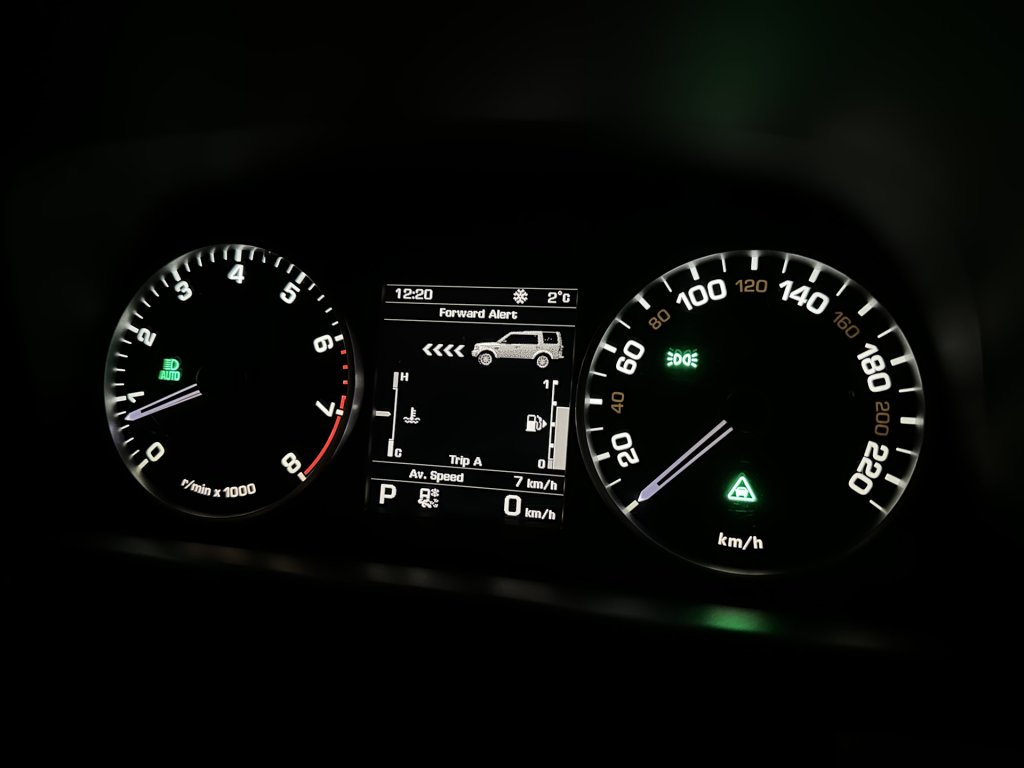

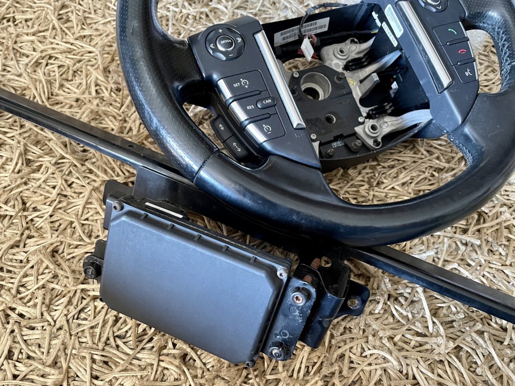

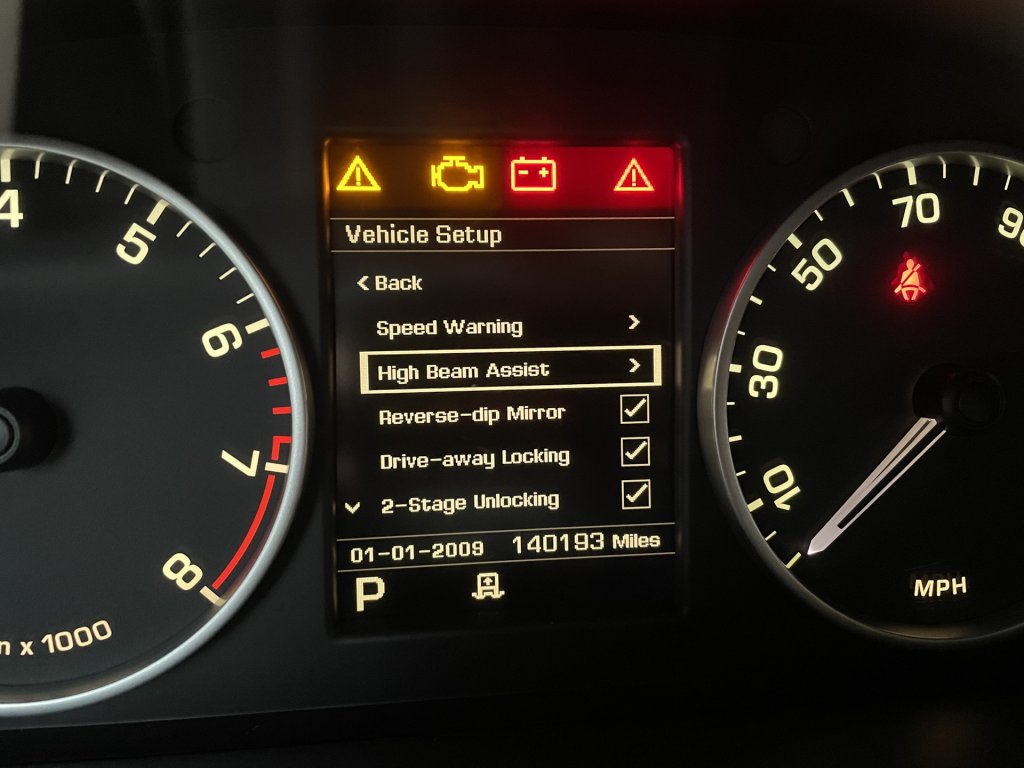

Did those require new parts or were they features you enabled in the software?
For the High Beam Assistant you need new interior mirror with sensor (ah42-17e678-ad for LR4 but I used mirror from RRS 09-13MY) + new plastic cover and of course change ccf, after that you get new lamp (AUTO) and menu in instrument cluster ;)
For ACC, absolutely impossible for 09-13my without special hardware, but for 14my and up probably only acc + loom + steering wheel buttons + ccf
