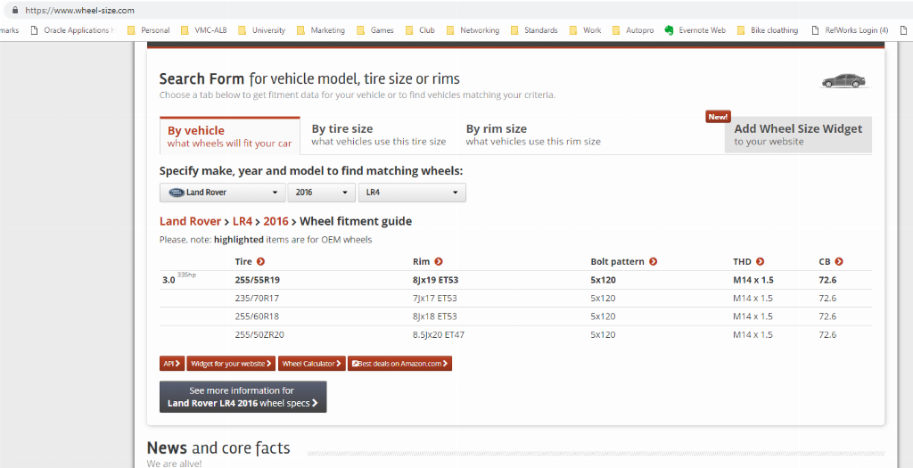

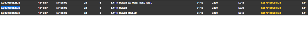

Coming back to this thanks for the information. I found the following wheels
I just want to know the offset for Land Rover LR4 2016 +53 but on here it shows +38. is this going to matter?
https://imgur.com/XxUNnPy
+38 should be fine with an 8" rim. I'm running +40s with no issues and compos are +44 I think. All really close.

Ok I just researched what offset is,
So from a +38 to the stock +53 is -15mm difference so just over 1/2 inch.
So when putting on a +38 you are moving inner wheel closer to the calliper.
The problem that must be happening between the stock LR3 18inch +53 and the LR4 19inch +53 on a 2016 SCV6 3.0 L126 LR4
Is the inner arch of the wheel, and the calliper. The arch must be thicker or the arch is not as deep causing the calliper to touch. Then by adding a 1.25 inch spacer makes it work.
It would be interesting to know the different callipers used in the different LR4 2016 models. As the TDI and the SCV6 can fit different wheels
