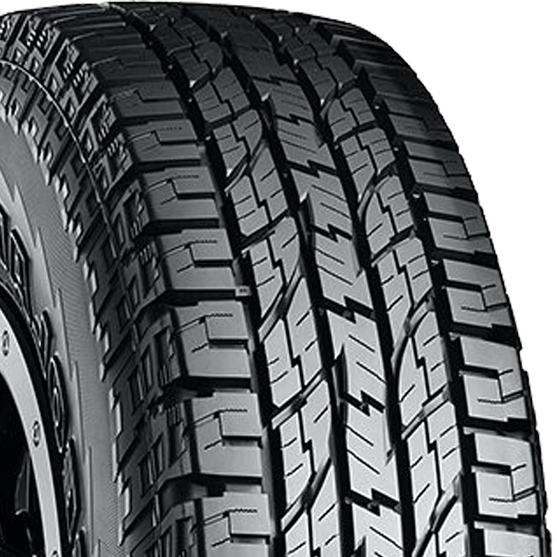

I had to go back to the post below to remember I had researched this a bit when I first bought them, there are photos of them being tested when they were launched and some sizes are beefier - the 255/55/19 was just released at the end of 2019, so they may have modified it for this size considering it is most commonly a street tire size...
The pics in the link below are when new, but it was snowy/wet and they are dirty so it hides the tread.
Review of Continental TerrainContact A/T
One has a more square edge:
