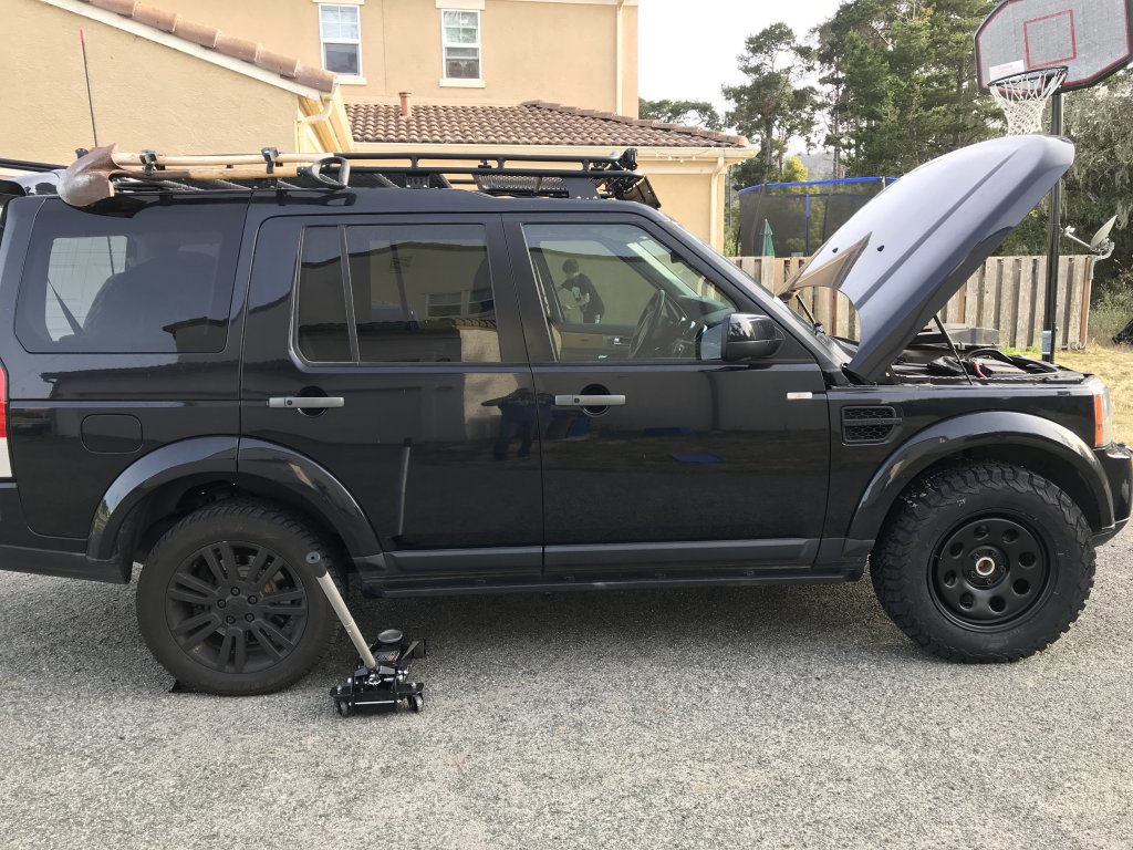

I have a 2012 LR4 and I've had both 19" and 18" wheels. Most of my driving is highway, but I hit the trails 1-2 weekends per month.
I had the Cooper Zeon LTZ 255/55/19 tires for 1.5 years and they were great. However, when airing down there is practically NO sidewall and my tire separated from the wheel on two occasions on trails. A rock sliced right through my sidewall on the White Rim Trail in Moab 3 months back.
After the Moab trip, I ordered 18" wheels from Lucky8 specifically for LR4s to fit over the larger calipers. Currently I'm driving with BFG KO2's 275/65r18. There is so much more sidewall...it is a noticeable difference on the trails when aired down as far as handling due to the much wider footprint as well. I absolutely love the look and handling.
A few notes: I have a lift and had to modify to fit. I've heard 265/65r18s don't require mod-ing your vehicle.

View attachment 8398 I have a 2012 LR4 and I've had both 19" and 18" wheels. Most of my driving is highway, but I hit the trails 1-2 weekends per month.
Do those wheels require a spacer?
