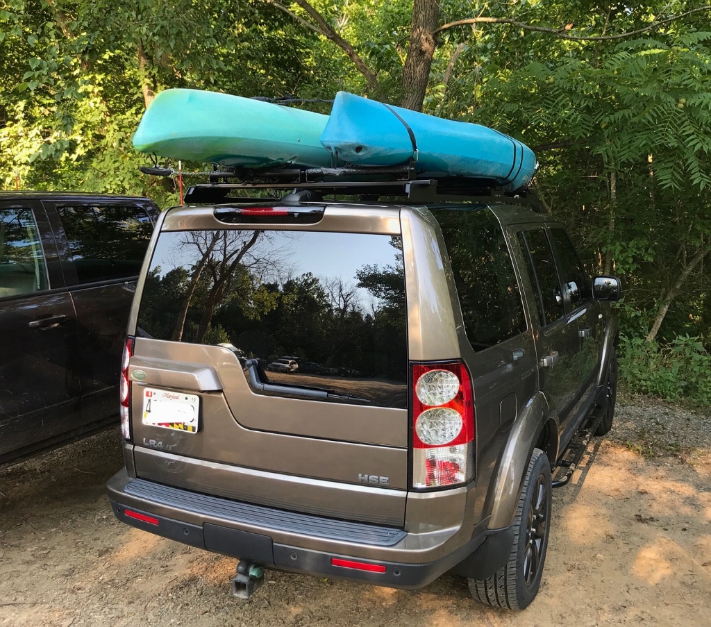

@TCM75 , not to muddy your decision waters, but figured I'd throw out the ones I installed last year (Voyager Rock Sliders With Step) into the mix as they seem to fit your criteria. I also looked at the two you mentioned, but ended up with these. They are heavy duty functional sliders, and they also work well as a step.
A few other folks have them here who can comment as well. They are not the hardest core rock sliders, but they are certainly not just for looks. They'll support the weight of the vehicle (you can jack it up from the step) and come with a couple different finish options.
My small kids use them as steps to climb in and out of the car. I use them to step up for roof access. And I like the look of them. I also liked that it's an independently owned company and you are likely talking to the guy who owns the company when you call. They are made to order in his Florida shop, but he keeps some inventory on hand as well.
There's pics on the web link above. Here are a couple from my car. didn't have any close-ups, but you get an idea of how they look and how far they stick out;

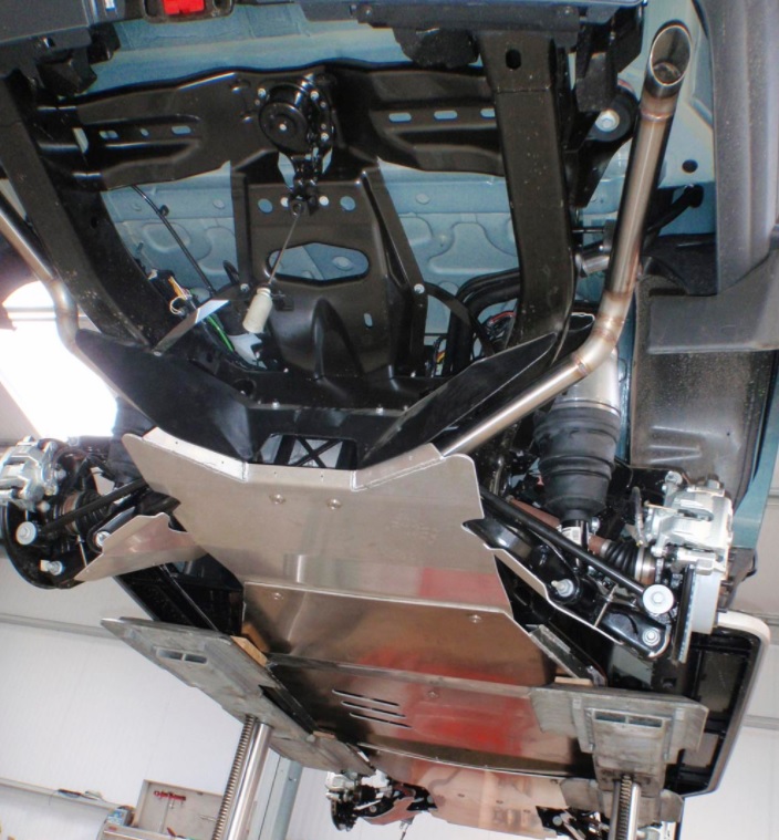

The prospeed sliders are really meant to be one part of their whole kit and not provide an underbody protection, just a lateral protection. The reason being is that they designed a full underbody protection that comes in pieces. They pretty much have a peice that will protect everything, from the air compressor to the control arms to a 4 peice front to back setup. They broke it down to me somewhat like this:
1. If there is impact, you can repair/replace a smaller "peice" rather than possibly a large "fits all" peice.
2. It can be burdensome to remove large "fits all" pieces to clean/remove debris rather than remove just those that would catch debris
3. When you put the items on in smaller pieces it's easier to add/remove.
My overall thought on why they did this after looking at the price....they can make more money selling it in pieces $$$ lol

Oh and if you're wondering what that will cost, front to back, all 10 pieces...around $5k w/shipping.....yowzer...

Thanks for the images, iSurfsilvano, now the ProSpeed "system" makes sense. I am definitely not looking to invest that much.
