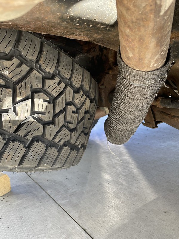

I'm getting the same tires and size installed next week. Rather than taking the hitch on/off to get it back in the original location, I'm planning on removing the heat shields and just using some exhaust wrap on the pipes near the tire.
I did a similar thing on my RRS when I fit bigger tires and I never noticed any issues.

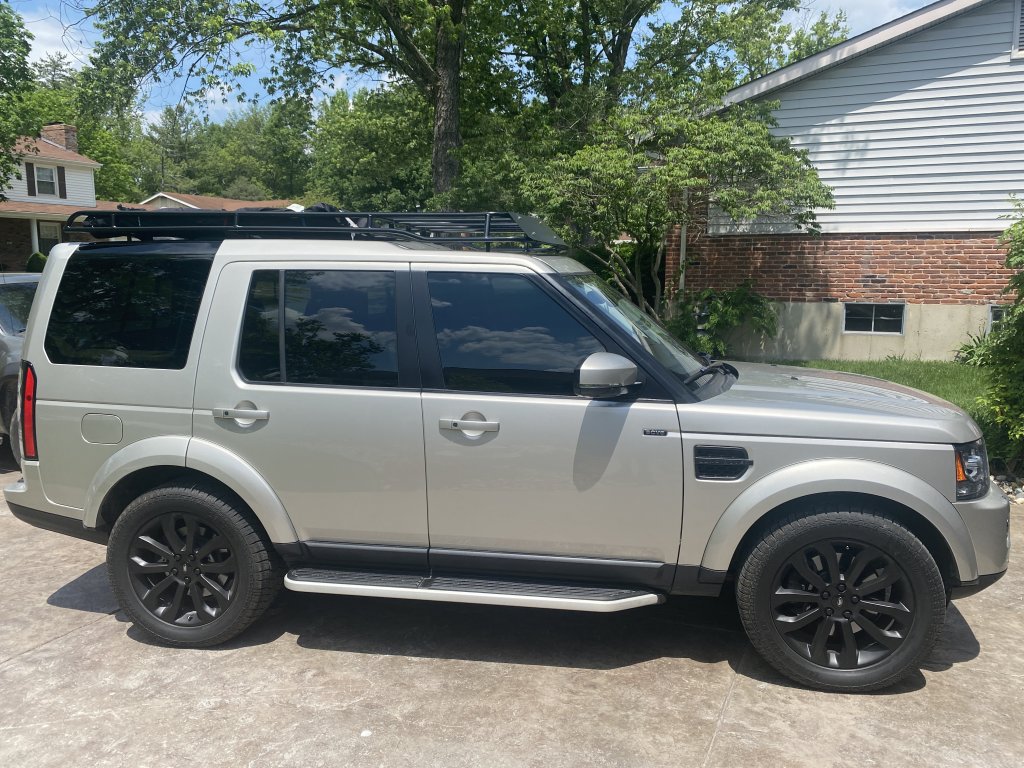

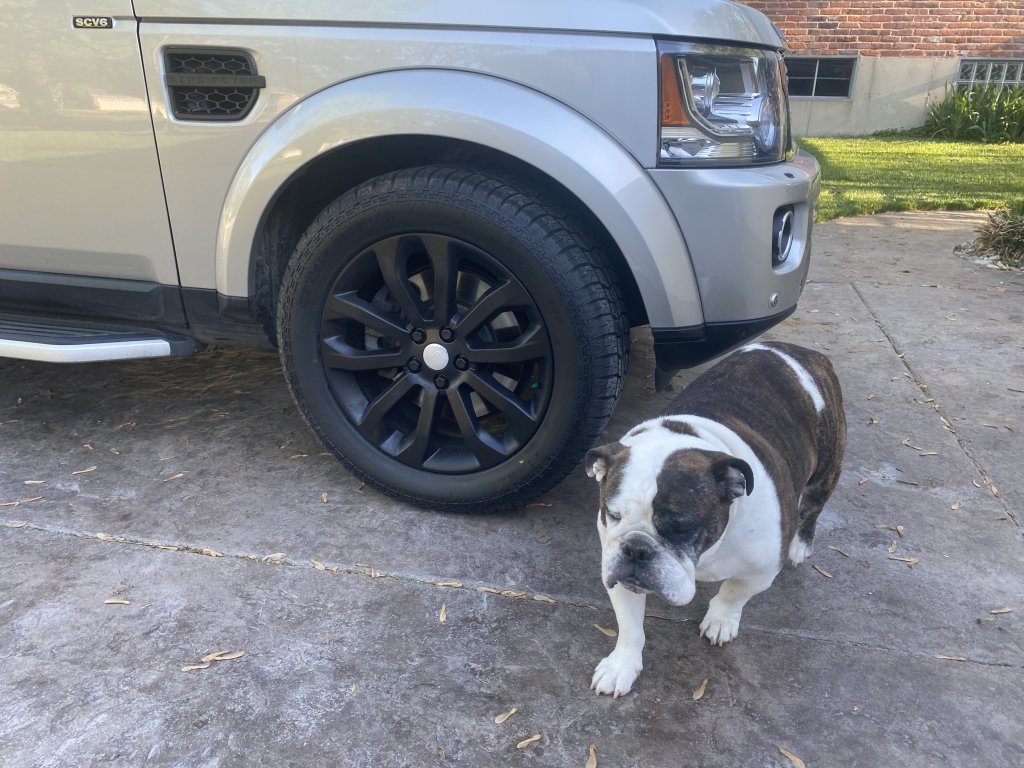

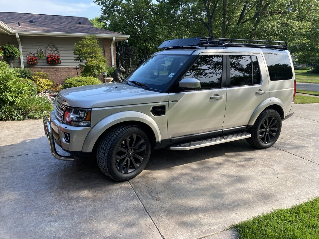

I am running
Lexani Terrain Beast AT 285/60R20 125 S Tire-on oem rims I blacked out. No mods only very slight rub when backing up with steering pushed all the way to one side. I think it fills the well and looks great​

BumbleFK - Looks good! I do like the way they fill up the wheel well. The BFG AT in this size shows 33.5" with rev's per mile of 622 - did you notice much difference in the speedometer vs. actual? What about the spare - we're you able to get the same size tire to fit in the spare tire area?

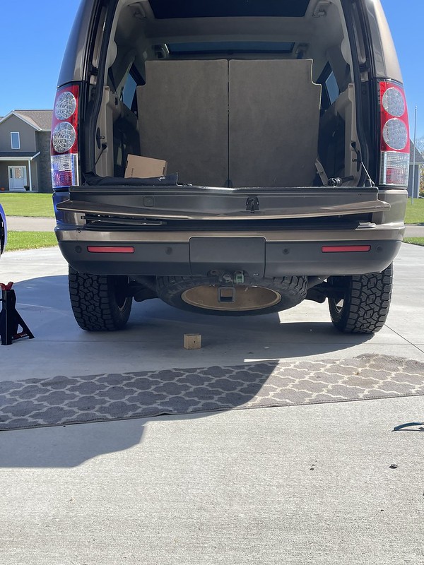

Well, got the tires on and went to put the spare back, and the stupid spare tire winch failed on me lol
Ordered a new one, should be here Friday and I'll try again then.

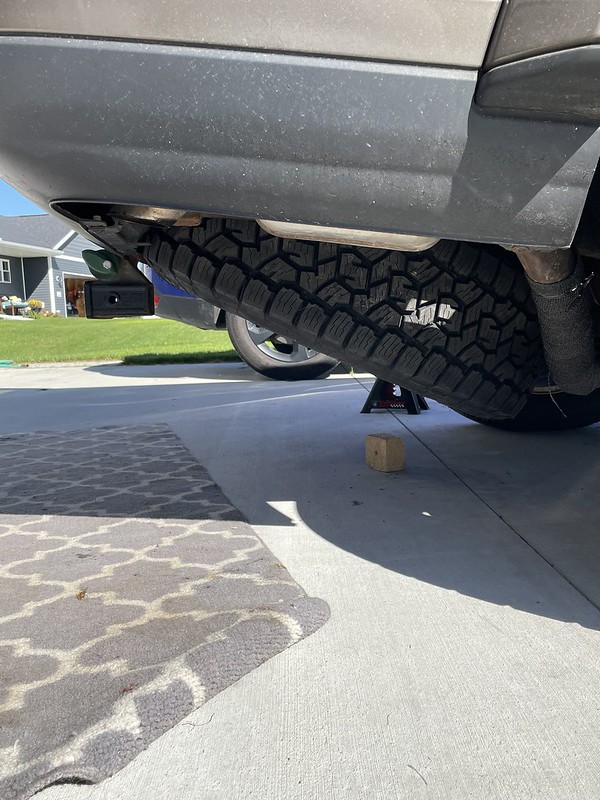

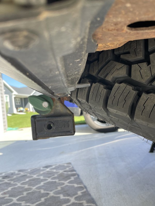

I tried multiple different approaches (front of the tire up first, back up first, etc), but on mine a 255/60/19 will not fit with the tire fully inflated and the hitch in place. I removed the shields which bought me a bit of room, but the tire is still pressed up against a part of the underbody/frame.
I don't have the key to remove the hitch so the tire is currently just hanging a bit lower than OEM size. I'll likely deflate the tire once I acquire an air compressor to keep in the vehicle capable of properly inflating it.
Hard to see here, but the back of the tread is caught up on part of the frame:
