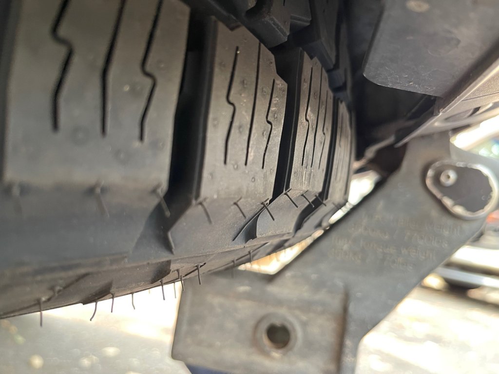

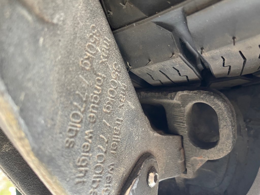

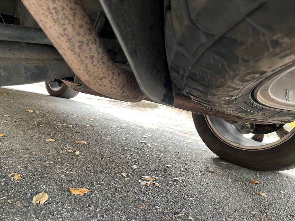

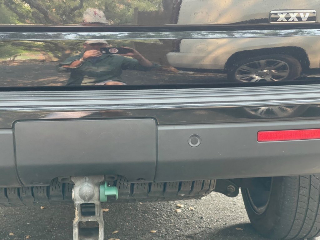

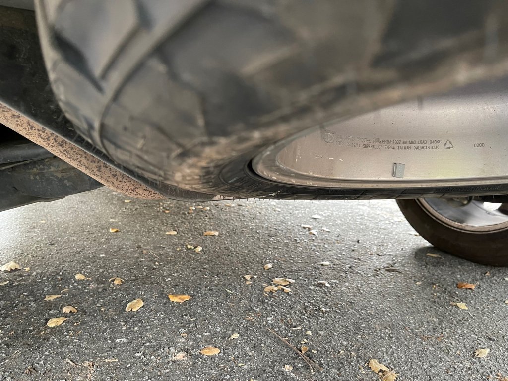

Perfect Fit fully inflated and trailer hitch fits - Toyo Open Country III Size 255/55R20. I will be ordering 4 new tires to go along with the spare.

I did have to remove the hitch to raise the tire up. I did not have to deflate tire to mount it in the spare tire area. Needed a little guidance to initially maneuver around heat shields, but once it was past the edge of the heat shield the tire raised straight up. The last couple of cranks seemed to take a little more effort since the fit is snug.
