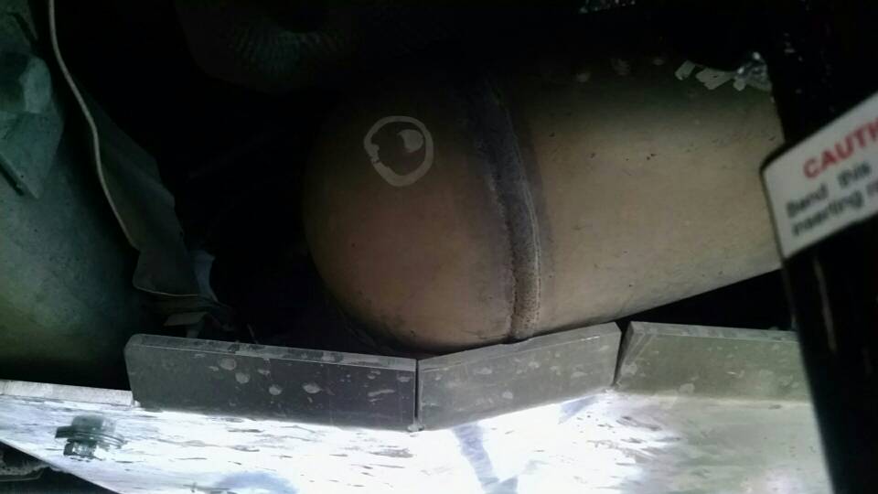

Problem: gear skid plate rubs

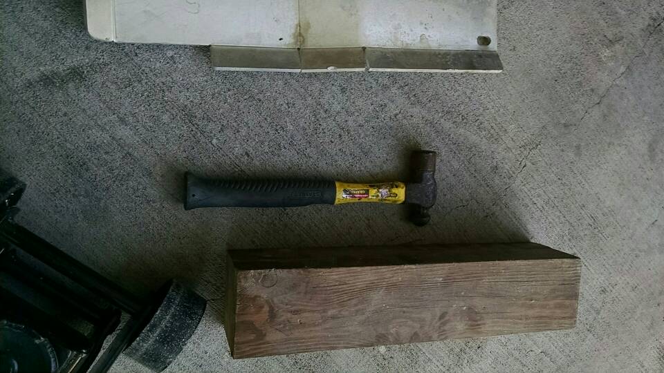

ivan gonzalez
Sep 10, 2014
227
Solucion: a bit of rough love
