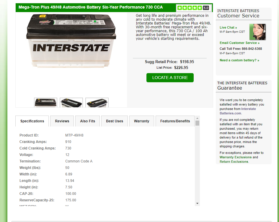

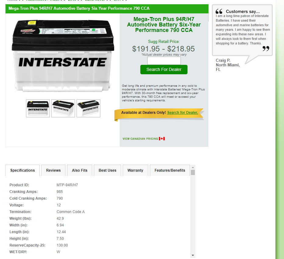

Which one is a typo? I went through the battery fitment guide and got this:
umbertob
Apr 18, 2006
2,701
433
California, USA
The H7 should read 640 CCA, 700 CA. The H8 appears to be accurate, give or take a few amps. That would make more sense (there's no replacement for displacement...) on two otherwise very similar batteries, one being a bit larger. I see that Interstate also markets a line of "premium" AGM batteries.
