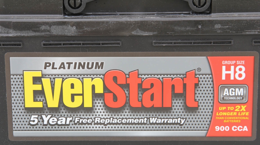

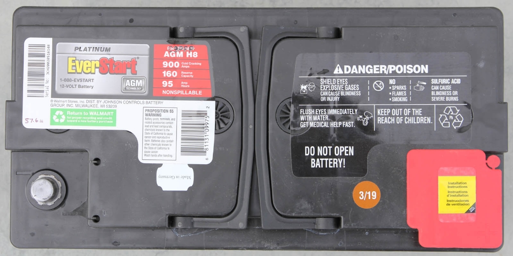

Walmart has a re-branded version of that Autocraft battery, both are made by Johnson Controls. They appear identical, including the "Made in Germany" sticker. The NeverStart version is priced at $150 plus core, which is the lowest price I know of for any Group 49/H8 AGM. And, as a bonus it claims to have a 5-year free replacement warranty. The AutoCraft is $197 but you may be able to get a 20-25% off coupon. But it still only has a 3-year warranty.
Only catch is, not all Walmart stores carry this particular battery. For a while, none of the stores in my area had them, but finally one store got a couple in stock. I picked one up a couple months ago for a different vehicle, I'll see how it works out in the long run.
https://www.walmart.com/ip/EverStart-Platinum-AGM-Battery-Group-h8/40647529
Photos below:
5 year "Free Replacement" and not prorated at around 59 months?
Had a 84 month battery from a friend's car he traded in, I gave him an old El Cheapo battery. By the 49th month the prorated amount I would of paid for replacement like 75% of a new battery cost.
Maintenance free like Delco's Freedom 60 batteries will die by 4-5 years due to the water levels below the cells due to evaporation over time. drilled out tops of cells a 3/16" bit, added distilled water then silicon sealant closed the holes. Still holding charge and cranking a 11 year old Delco Freedom 60 battery. Adding water once a year......~~=o&o>.....
