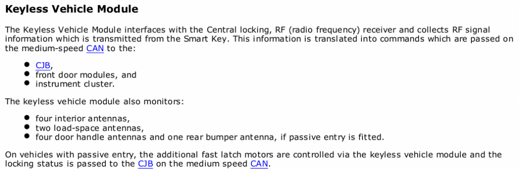

Page 4210 of the Manual has this:
CJB = central junction box
It sure seems there are a lot of Antennas! I'm thinking that the wiring diagram should have something in terms of the wiring but I'm not sure if this will help with the location of the antennas?

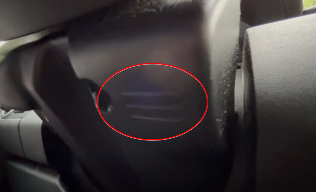

I'd make sure I know how recovery with the key works, I think you have to put it under the steering wheel or something like that!

If the battery in key fob fails, there are three raised lines on the bottom side of the steering column. Hold the key fob up against these three lines and the key fob will be sensed and allow vehicle to start (even with no battery in fob).

That's a good point - pull the battery out of the FOB and see if you can sort out how to get into the car and start it.
