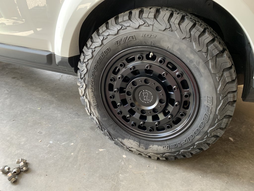

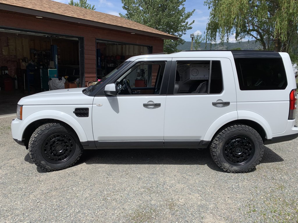

Hi everyone.
In short these DO NOT fit on the LR4 but,
I have these on my 2013 LR4 HSE LUX with 275/65/18 BF Goodyear TA/MK3s on them.
the front calipers will need to be altered a little to make them fit. rear is fine
to make the tires fit, part of the frame, the piece that sticks into your wheel well will need to be cut off.
Johnson rods right now, but adding bump stops and increasing the lift by 1 additional Inch with the gap tool as there is still some rubbing on full turn to the right.

Update: these 18” wheels do in fact need to have the calipers shaved slightly. Just on the front as per blumountain noted Above

They look great. Any rubbing otherwise?
Edit: Oops, missed the post above. The issue there might be that you decided to go with 275 65 18s rather than 265s. Anything above a 32 inch is a doozy on these trucks, rods be damned. I run 31.9s and I get slight rubbing.
If your referring to my post, no rubbing at all other than full lock. I couldn’t tell if you were commenting on my post or a different one.
