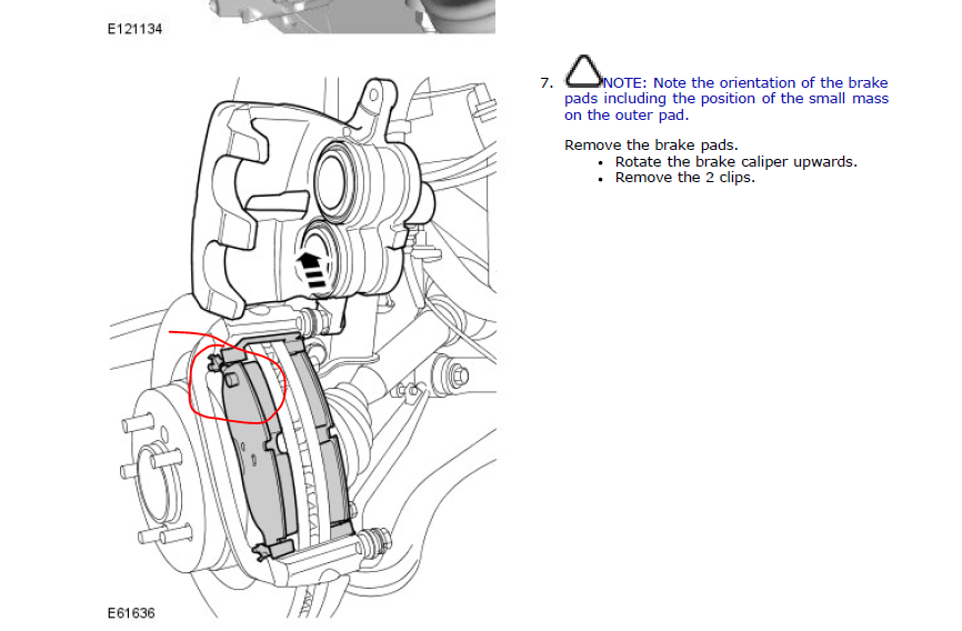

weight up high and to outside (on pads)
bush pin on bottom

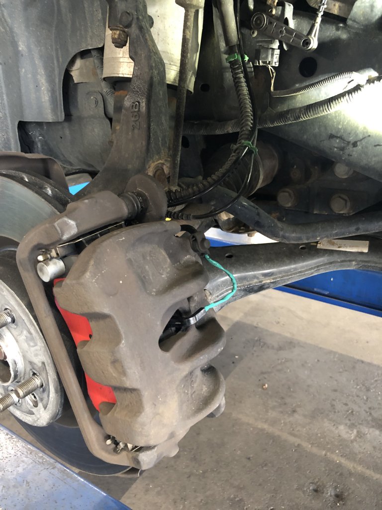

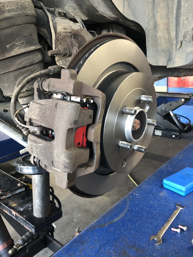

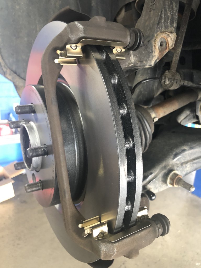

I replaced all rotors and pads with Brembos on my 13 and yes, they still have the two types of pins. Removed and cleaned, relubed them. Make sure you remove the air bubbles when you insert the rubber covers for the pins.
I will occasionally have some noise, which I blame the pads. Next time I'll be going with akebonos.
