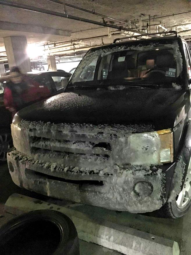

I recently drove from DC to NYC in Monday's snow. My LR3 rode like a king while I saw few suvs slipping every now and then. I used snow mode throughout and when I finally parked in garage on arriving, I thought I had the smell of something burning, like rubber. Opened the hood but everything seems fine. No heated area . No warnings as well. I recently changed tires to OE size duratrac all weather. Didn't smell this before post tires change. Though it was on grass and snow mode throughout this drive, the front was blocked by ice, which may have blocked some air going in. See picture.
Any idea what's going on?
PS: Also noticed that mpg was around 17.1 while on the older tires it used to be 19-20 on highways (summer)..

On my LR3 and other SUVs I've driven I've gotten a burning/heated metal smell after something similar and determined it's the road salt and water boiling off of the exhaust pipes and heated engine block.
I'm not sure I would drive the highway at high speeds using the snow-mode but I admit I haven't checked the owners manual on that. I've used it for around town driving but don't usually bother, including the horrendous mush snow we had a week ago this past Friday in MA.
Looking at the picture, you have a lot of road salt and crud crusted on the front. Get it cleaned off and see if you have the same smells....

Agree with whydahdvr on the burning smell. Don't worry about it unless you smell it again once everything dries out.

Everyone, thnx for chipping in. On my next drive, I didnt get that smell though the drive wasnt too long. Will check whenever I goto dealer the next time though for now, it seems fine.
