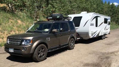

Been busy getting it set up and getting the hitch (Andersen) set up. We drove it straight from the dealership on Tuesday to a nearby state park for a shake down.
We love the trailer. I've been pleased with the weight. It is easy for me to manage the tongue weight between 680 and 720 lbs (depending on how much, if any, water there is in the tanks.) The Sherling hitch scale has been awesome. Easy to use and takes all the guessing out. As for the Andersen hitch, I didn't get it set up right at the dealership (I did it myself) so my first towing experience (from the dealer) was a bit unnerving (busy freeway and heavy wins). But I finally got that set up yesterday and it pulled great today as I brought it home. BTW, the total weight with all the installed options and two full propane tanks was 4,971 lbs. We will be loading it with about 300-400 lbs of stuff. So this is well within the range for an LR4 - but not IMHO the OEM hitch receiver. So I reinstalled the Curt hitch and moved the tire to the top of the LR4. I'm also loading my off road and emergency gear (chains, jack, etc) forward of the rear axle on the LR4 as we don't use/need the middle row. All of that may not be necessary but since I have the space I thought I would move more weight in the LR4 forward.
Now, the only problem I am having is that I apparently don't have the Trailer Assist functionality installed on my LR4. At least it is not available. The setup screen (under the Cameras menu) does not have the setup option/button. But I will say that the ability to raise and lower the LR4 with the keyless remote is very handy.
Here is a quick pic with it all hooked up. (And a pic of the boxes sent to me by Hensley as I am selling their hitch back to them at a third of what I paid for it. I took a big hit on it but although it towed great, it was simply too difficult to connect and disconnect and maintain. IF the Andersen works out it will be much simpler.)
I'll do more pics when we are in more picturesque settings. ;-)

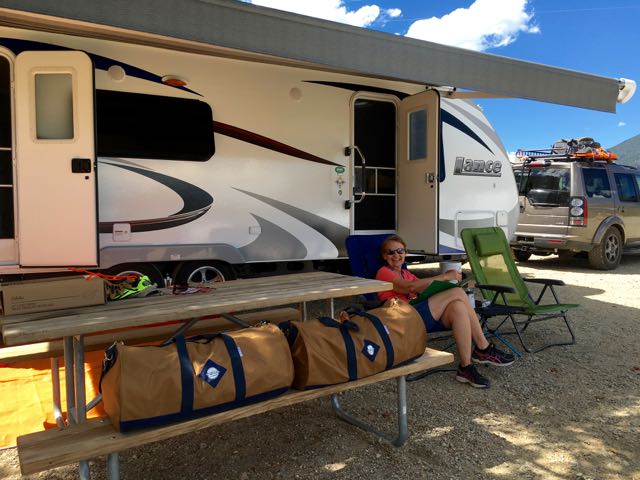

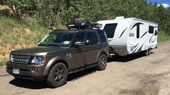

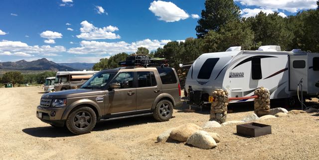

Jury is out on the Andersen for me. A lot of people really like it. But I was pulling my trailer through some significant cross winds on Sunday and it was rather unnerving. Maybe I don't know how it is supposed to feel pulling a trailer. But the winds were knocking me around quite a bit and had me seriously concerned. I think trying to pull a 5500# travel trailer with an LR4 is enough of a challenge. Since I still have the Hensley Cub I used last year I am going to back and try that on the new trailer. We'll see if it makes a difference.
Here are a couple pics from this weekend's trip. The first is at the top of 10.000' Kenosha Pass. The others are from our RV site near Buena Vista, CO.

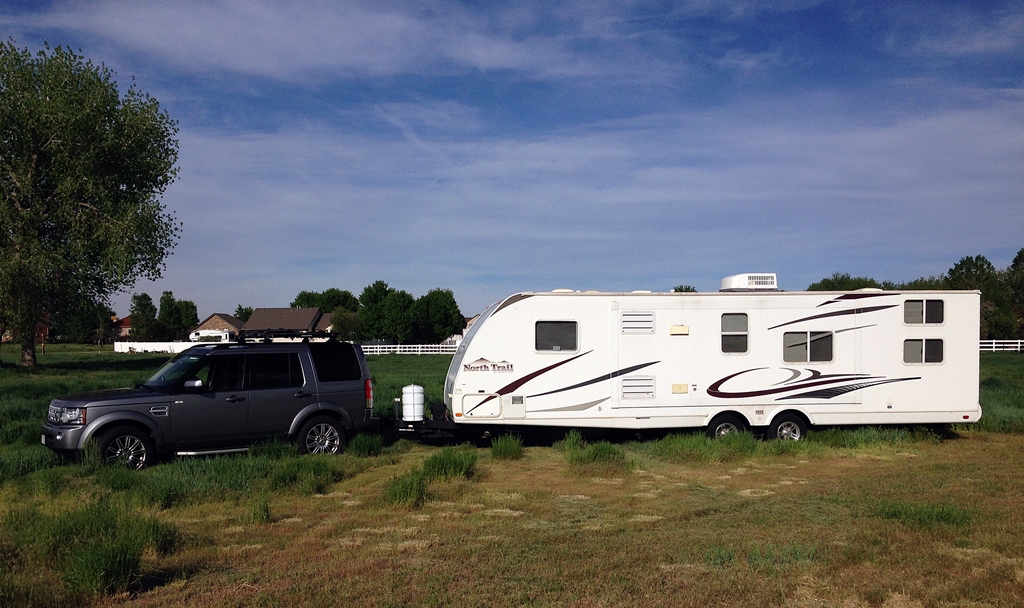

Here's our LR4 hooked up with my Northtrail 31QBS...we are actually casually considering trading our 31QBS for a different floor plan, since our kids are now both teenagers and could use bigger sleeping bunks (have been looking at several of the double-queen-bunk model offerings while still staying in the ultra-light travel trailer category). Setup is Rhino Hitch + Equalizer Hitch for Weight Distribution and Sway Control.
