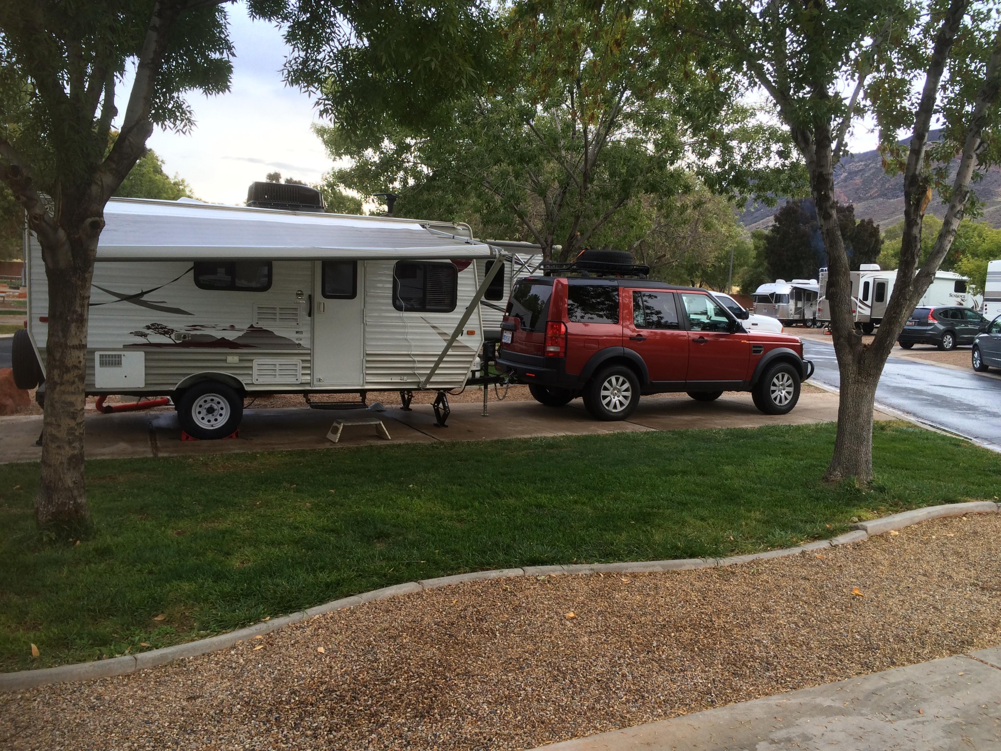

I pull this lite wt. 3500 lbs with my lr3, Eckhart hitch welded to the frame, no anti sway its irrelevant with the lr3 towing capability. Over the rockies in the snow twice in the last year Tows like a dream,
How does the Eckhart receiver work, what towing class (trailer/tongue weight - your isn't as heavy as mine) is it rated for and does it allow you to store your full size spare in its normal location? It looks like it is a "weld on".
Diesel101
Jun 4, 2012
18
Eckhart is welded to the frame where the spare would go, No matter to me because I run 275/65/18 with johnson rods so the full size spare go on the roof. Hitch s rated 5000lbs.
Trailer tows like its not there, cruse control most of the time.
