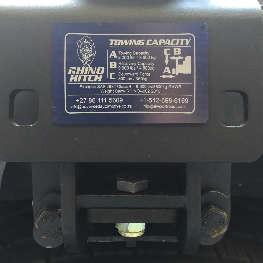

At 750 you are near the top of the LR OEM rating. (97% ?) Not sure what the Rhino is but do know it is limited by the LR4. It is class IV but the LR4 is class III.

One last post for tonight. Appears Rhino Hitch would be the solution followed by total trailer weight LR4 spec. The OEM hitch really limits you.

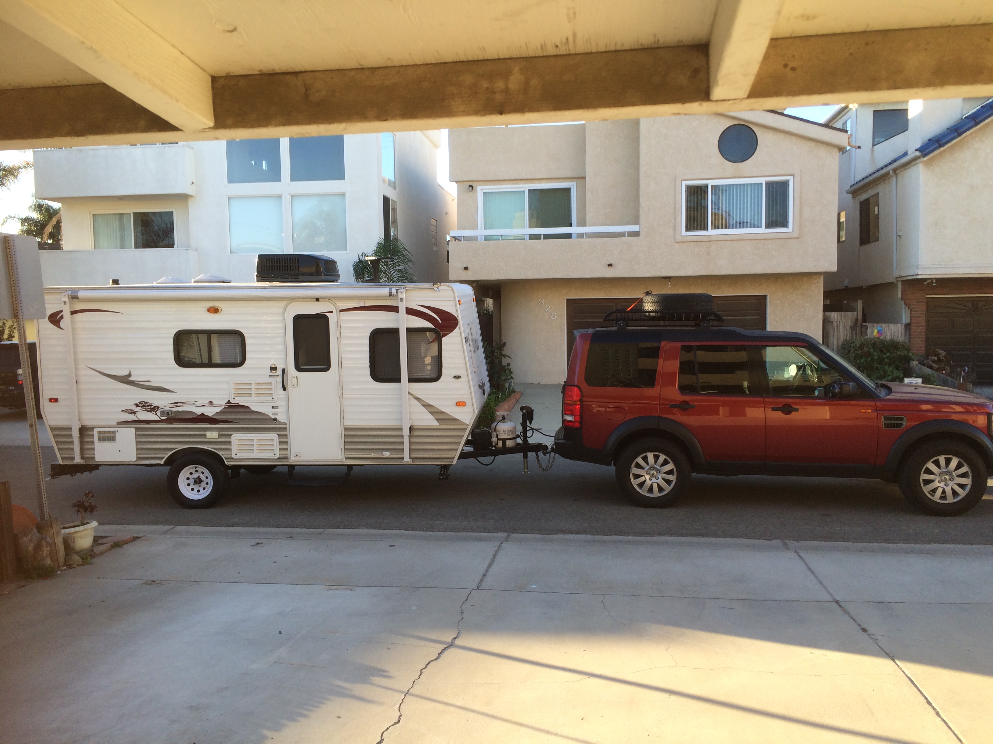

I pull this lite wt. 3500 lbs with my lr3, Eckhart hitch welded to the frame, no anti sway its irrelevant with the lr3 towing capability. Over the rockies in the snow twice in the last year Tows like a dream,

FYI for Dan, this is the plate from my installed Rhino hitch.
