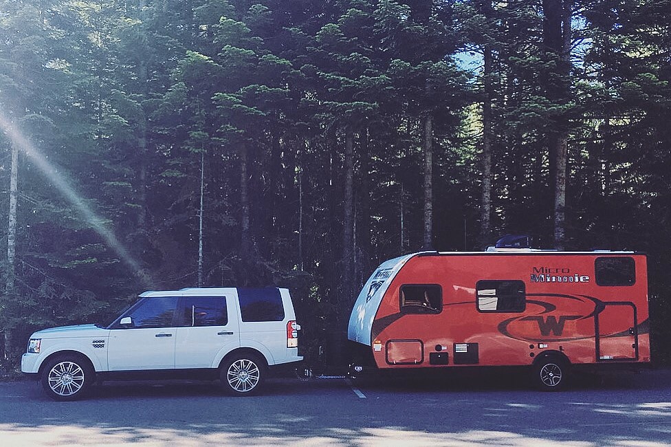

Sweet setup Churious! Love the red trailer...Can't say I've ever seen one and I've been camping for decades... Very unique...
Here's our setup... I towed with the LR for the first time over Memorial day weekend myself. The truck towed our unit beautifully and hitched up with the OEM hitch and stabilizer system with ease. Two thumbs up for the LR4 towing experience...
I really like the new pop up designs. Due to hunting and potentially camping in cold season I went with an all hard wall trailer but I really like the run and gun mentality of a pop up!

Churious, I don't know where you live but if you are in Colorado I'll keep an eye out for you. I don't think you'll be hard to spot with a red trailer. Pretty awesome looking.
Im in WA state. With this setup I will most likely be in the surrounding states of ID, MT, OR and maybe a bit of UT. Rarely get to Colorado as it is but its a beautiful state!

Maiden voyage was a huge hit and the family had a great time. :hello:

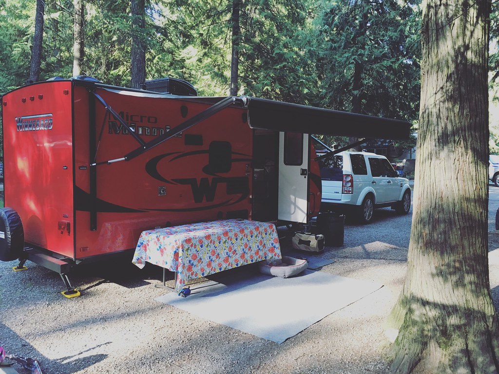

Ha! We drove by that campground yesterday and almost drove in to check it out. Nice trailer and nice additions. You are definitely ready for some boondocking!
You won't find us in the forest service campground ...... keep headed North over cattle guard crossing.

Love it! How much weight do you have on that rear bumper? Did you reinforce it?
Welded square steel tube frame with extended side tubes welded to top of camper frame, steel floor, square steel tube (3/4"?) supports that extend from outside edge of shelf to lowest point on frame to create wedge support. Roughly 50lbs for generator with EU2000i locking baseplate that is welded to shelf and roughly 200lbs of water/tank.
Nice. Im reinforcing mine to hold approx 100lbs with a bike rack.
