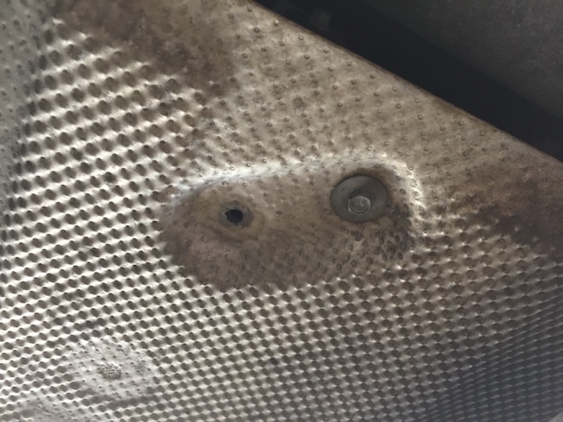

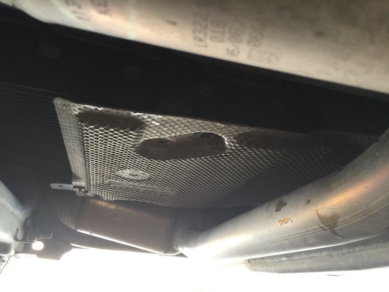

Hi everyone. Just following up to this thread. I have not pursued a remedy yet but I'm still being plagued by a vibration sound seeming to come from under the passenger floor. It commences at 20 to 30 MPH and continues at highway speed and it only occurs with throttle-- let your foot off the gas and the buzzing tops.
Looking underneath the vehicle this morning I noticed some water drips coming from the edge of this screen located in the center of vehicle. Would this be condensation from the air conditioning? I noticed one bolt is missing and the cover is somewhat loose... I wonder if this protective cover could be the source of the vibration? Although it's not under the passenger floor and I'm not sure a loose cover's vibration buzzing sound would stop when you let off the gas.
What is this cover called and where would I get a replacement bolt? Thanks!

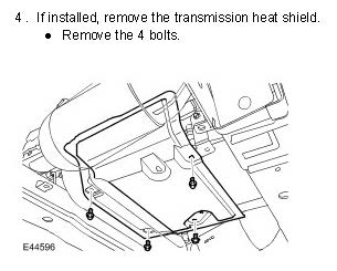

I am going on slightly vague memory, but that looks like the transmission heat shield that I had to remove to replace my shifter assembly cable. If I recall there was only 1 bolt even though there were two holes.
Perhaps all you need to do is tighten them up?
