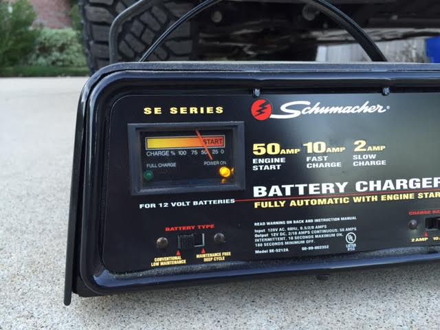

Pulling into the garage last night the LR4 started to overheat and threw a charging system fault warning with the red triangle and battery icons lit up. Shut er down within seconds as I was literally backing into the garage. Let it cool off overnight and this morning she started no worries but there's no power steering. Threw the Schumacher on the truck to see where the battery was as far as a charge was concerned and she's low as hell. 2016 with 2042 miles on it. My normal commute since taking ownership has been 35 miles on mostly freeway at 70+ mph so it's confusing as to why the battery would be so low.
She seems to be taking a charge ok now so I'm gonna try and limp her into the dealership.

Sounds like you have a bad serpentine belt.....overheating, loss of charge, power steering failure...all components driven by the belt.

Upon further investigation you can see a massive wobble on the belt as it traverses some unidentifiable pulley when the engine is running. Road Side Assistance is en route to pick it up. As an aside the battery took a full charge so it's def not a battery issue.
