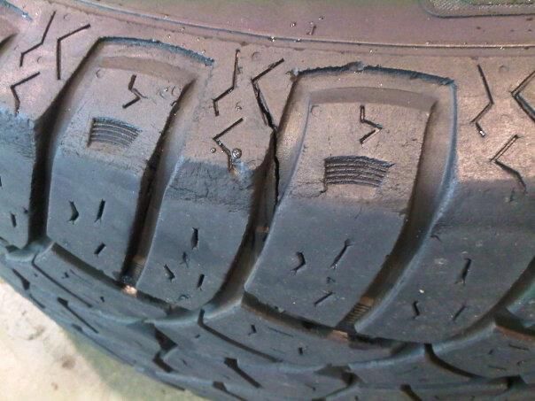

Just wanted to give you guys a heads up on this and have seen other reports of this issue.
I had a Cooper Zeon blow out (purchased set July 2010) have plenty of tread left, tires are rotated every 5k miles. After inspection I noticed deep cracks under the tread/knobs that continued down the sidewall. I looked at the other 3 tires an every one of them is like this. This happened to all 4! All on the inner side (not the side facing out). Will be contacting local Cooper dealer in the am and see what to do.

Yep same cracks as that picture. Went to local cooper dealer and they inspected the tires, have 8/32 still left and got Cooper on the phone and they authorized the replacement of 4 new tires and I just pay for mounting/balance. Just stinks I have to wait a week for the new tires to get here. Oh and the tires were 14 mos old and had 37k miles on them.
