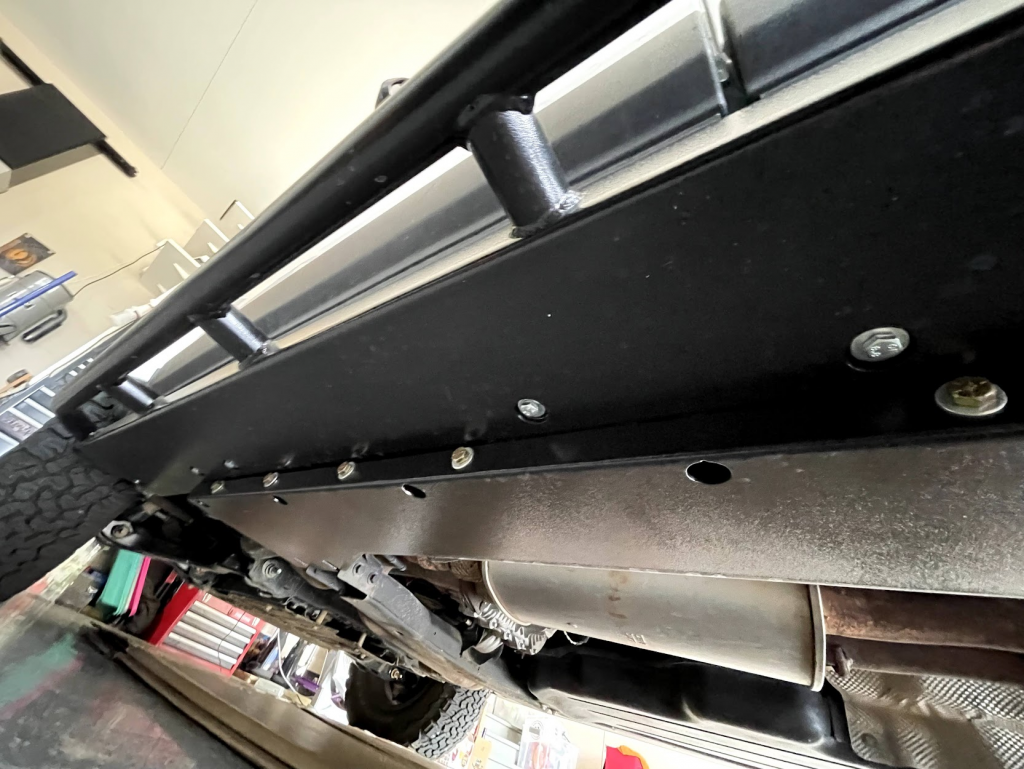

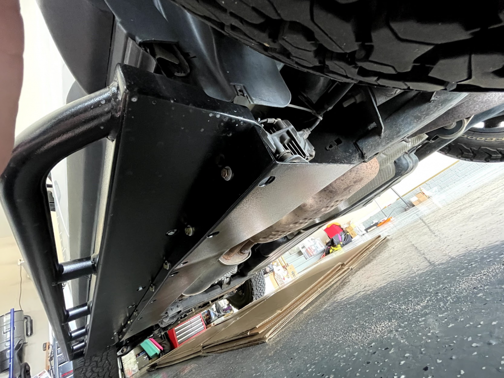

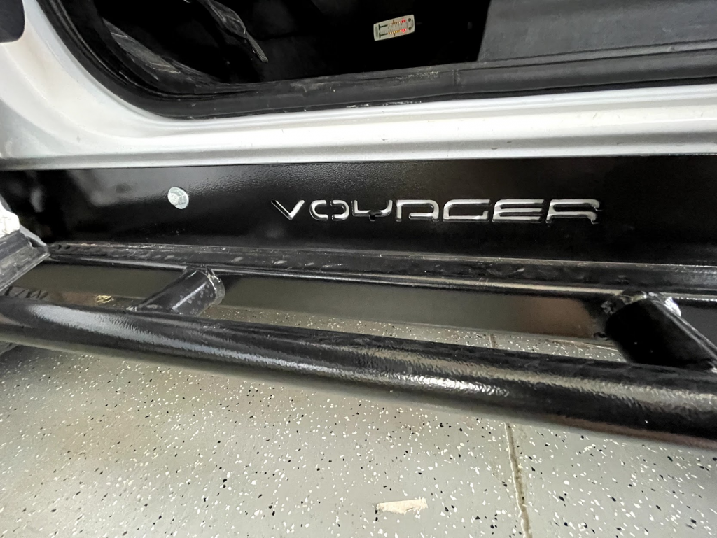

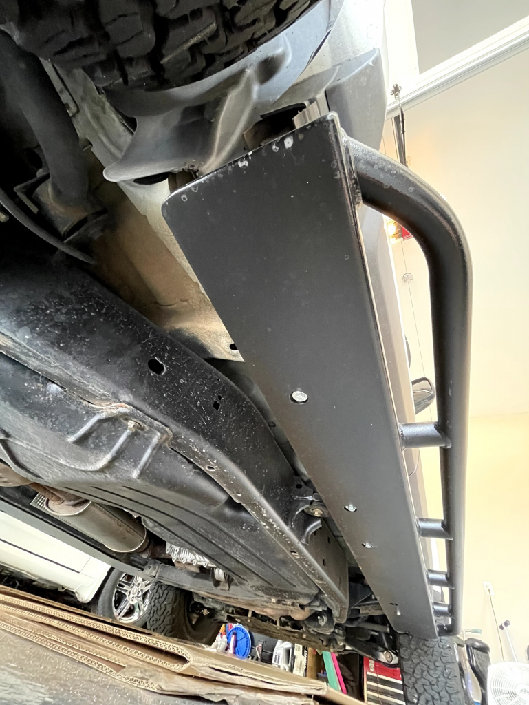

I had the tactical sliders and sold them. I went back to the Voyager slider and I worked with them on a new version. The version we made has a bolt on plate on just the driver side that protects the air tank and compressor. You can remove it and access the full air system without dropping the entire slider. I did this for a couple reasons. first is weight, the t44 sliders are just too heavy. second is I actually didn't want them on my frame/body mounts, they are lower along the sides than the voyagers. Also the Voyager sliders are way way more comfortable to stand on because the have two parts that your foot can be on and they stick out a lot more.
I love my T44 rear bumper, but I wouldn't go with the front bumper (ARB is just better looking, functioning and engineered and crash tested). And the sliders and skids are tough, but weight is a huge issue and I found it to be overkill. I rub a lot less without all the skids because everything is tucked up a lot higher. I just have to be more careful in some settings not to come down on my gas tank or a really pointy rock up between the front cross member into my transfer case or transmission. I may look into aluminum options for that area at some point.
Plus the t44 sliders hurt my feet when camping.. constant foot pain after climbing in and out of my rig or trying to access the roof rack.

This is excellent feedback. After I helped install the T44 sliders on a guy’s LR4, I realized they would add too much weight to my already heavy LR4 with an RTT mounted. I was actually looking at the TF sliders as much as I hate to admit it, just because how light they are. But I love Voyager products, as both of my L319 builds have their rack and rear ladder. I’ll ping Andy about sliders and bolt on cover. Is there any way to reference your specific custom sliders so that he can replicate it for me?

Not sure it has a model designation (one point of feedback I gave them was that they should have model numbers and even revisions with change notes somewhere. They constantly improve stuff just like tactical 4x4 does. I wish T44 did also because ordering parts like the rear latch is not easy because they keep changing ****)
I think the version they were selling before I asked them about mine had the same coverage, it just was one solid piece rather than bolt on. I can't say for sure that the bolt on part is better for hard use yet, because I don't have enough trail miles on them, but the use case I was trying to solve for was EAS issues on the trail... I don't want to drop the whole slider because it kinda requires a floor jack or multiple people. The bolt on plate is pretty easy to manage alone.
Just mention "the bolt on air tank and compressor guard version". Hopefully they have made more of those since mine.

Awesome, will do. I can DM you if something else pops up
