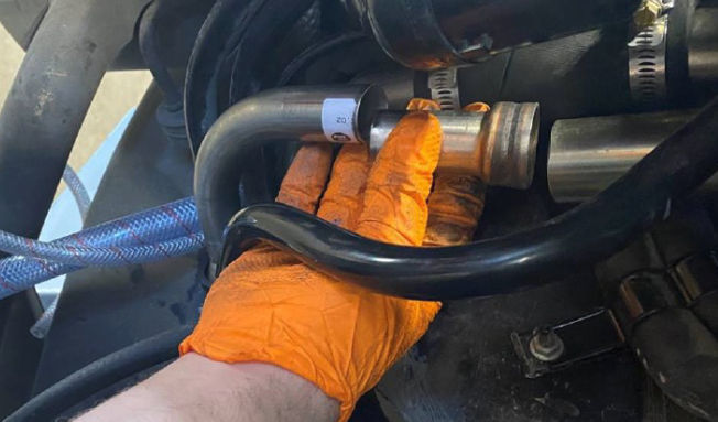

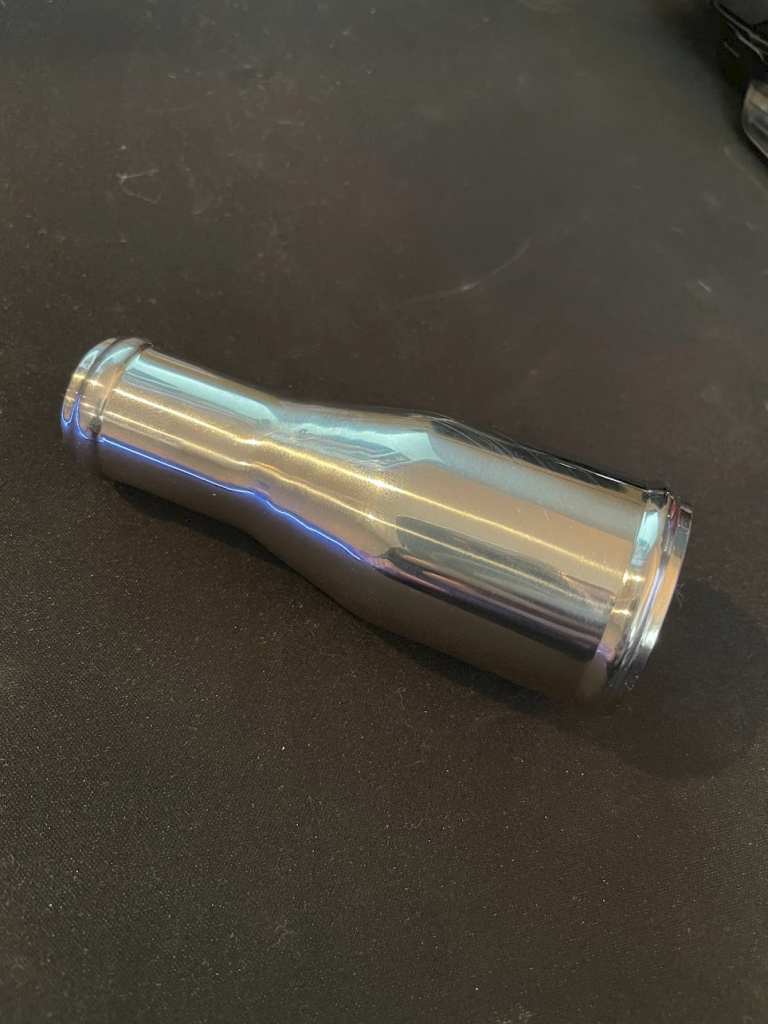

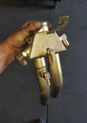

If you are referring to the size difference in the dual filler they provide and the OE filler tube size, then ya.. i will either have it modified or use the 1" to 1.5" fuel filler adapter I bought that is stainless. I don't plan on cutting the OE filler up to make adapters and all that crap they have in the instructions.
Other than that filler tube size issue it all looks pretty straight forward to install. I plan to do it myself.
It's been years, since I did mine, but IIRC, it wasn't so much a size difference, as it was having to weld an additional **** onto the supplied filler neck.
It will be obvious once you start the install, as you need to place to park each of the factory connections, as well as the connections to the aux tank.
From what I am seeing no modification of the dual filler neck is needed other than making sure the size of the filler tube matches the size of the OE filler tube. Everything else on the dual filler is good to go. As long as I adapt that size correctly (if needed, i haven't measured yet) then it should require no welding and no cutting of the OE filler neck if I use alternative adapters.
This shows the OE filler neck cut to make an adapter, but I would buy a pre-made gas fill adapter (stainless) and appropriate hoses if needed.
edit: I bought this...
View attachment 21612View attachment 21613

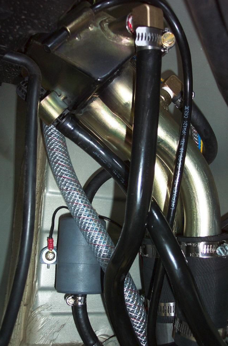

Hope it goes easy for you. As I said, mine was years ago. I think I was one of the first 3 or 4 people in the USA to get one of these tanks to work, so there might very well be differences now. I posted a thread back then titled So You Want An Auxiliary Tank that had the details.
As I said, you will love it once you get it working.
