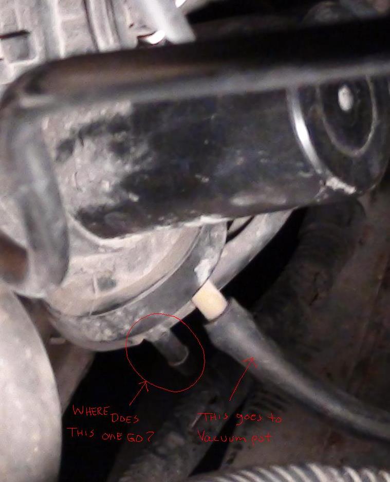

my cruise is not working and I know it is because of vacuum lines. I have replaced on but I can't figure out where the otherone goes to. It comes off the bottom of the unit, next to the one that goes to the ***. I can't find a layout of the connections (even on the rave cd)

Not sure what parts you speak of.... Pictures are worth a 1000's words.

Here is the picture
I'm sorry it is so zoomed in but this is the vacuum activated *** that connects to the throttle for the cruise. The old hose that came off has a nice bend in it that I thought would lead to its connecting point. I have tried that hose in every position and still can't find where it attaches.

Hi arshard, the D1 and D2 are completely different... on the D1 you have the pump with vacuum line going back to fire wall then a "T" on goes tot he brake swich, the other goes to the Rubber vacuum holding thing (as you put it).
Common issues on the D1 are the hoses, fuse, rubber holding thing (I like that term) and the ECU not responding properly)
The D2, I have to either check with a friend or something as I haven't had to pop the hood on a D2 in a while...
