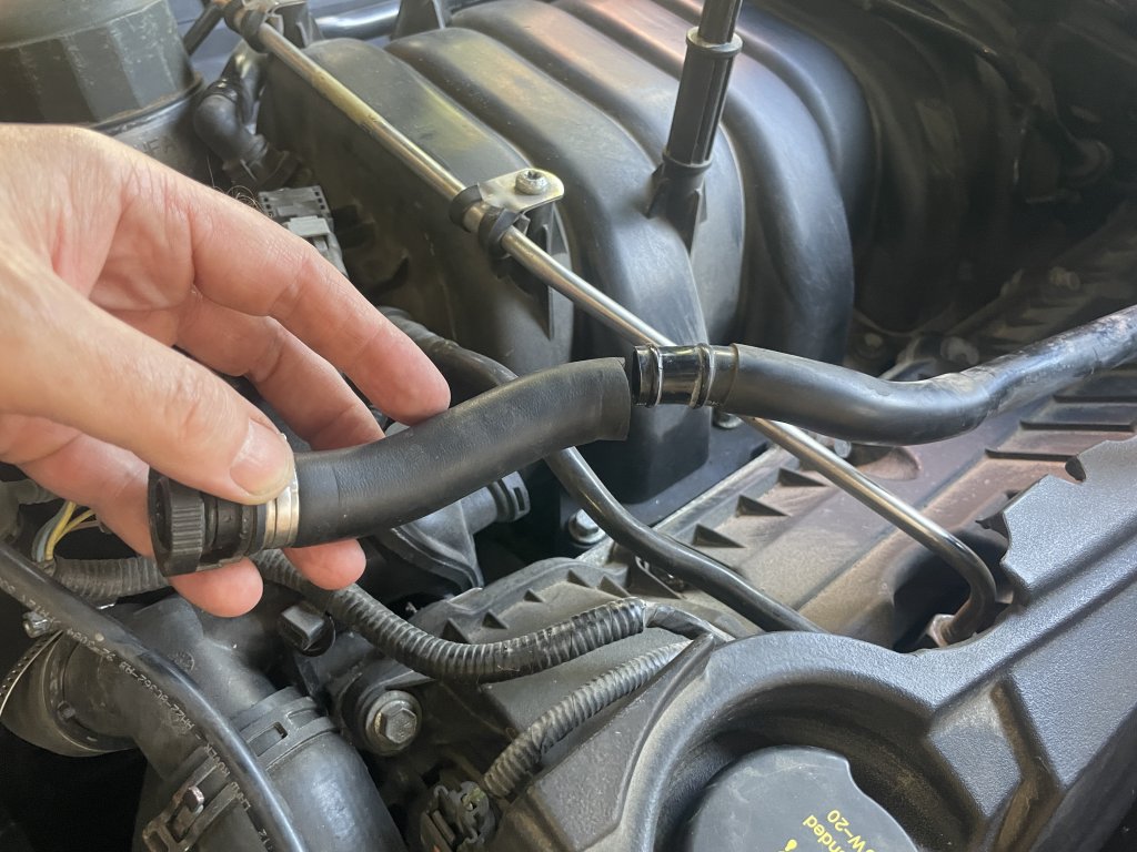

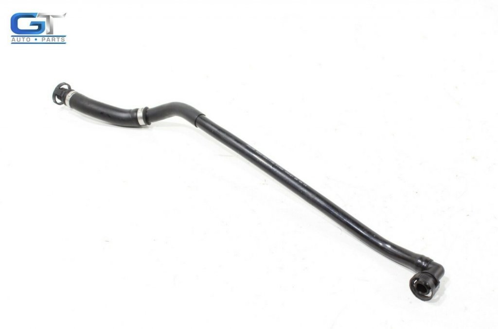

But wait. There’s more. I fixed this for $49. An emissions hose on top of the engine that runs from the intake back. CE light has been off for about 2k miles now.
