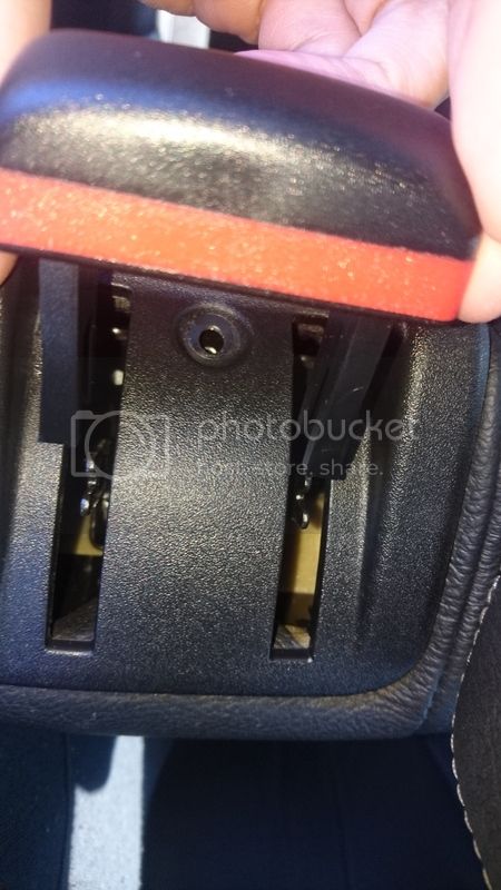

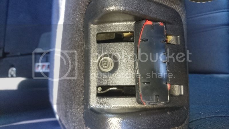

Do not ask me how this happened, I only imagine the previous owner dropped something on it or chewed on it. Who knows. Anyhow, I didn't have a thin yet sturdy enough plastic prybar to pry under the handle, so I started by removing the screw in this picture. You can access it by moving the seat to a midpoint position (so it's not latched up or down):
Next you pull on the side of the assembly that the screw was on, lifting the handle out just slightly, now you can get your fingers under there and pop off the old handle.

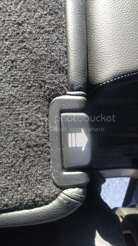

At this point, I elected to go ahead and put the new handle on most of the way, just to ensure I don't somehow lose the lever if the seat were to go all the way into locking position:
After that, I replaced the screw I removed, and gave the handle a few good heel-palm-strikes to seat it all the way, and walked into the house mildly disappointed at how easy that was.
