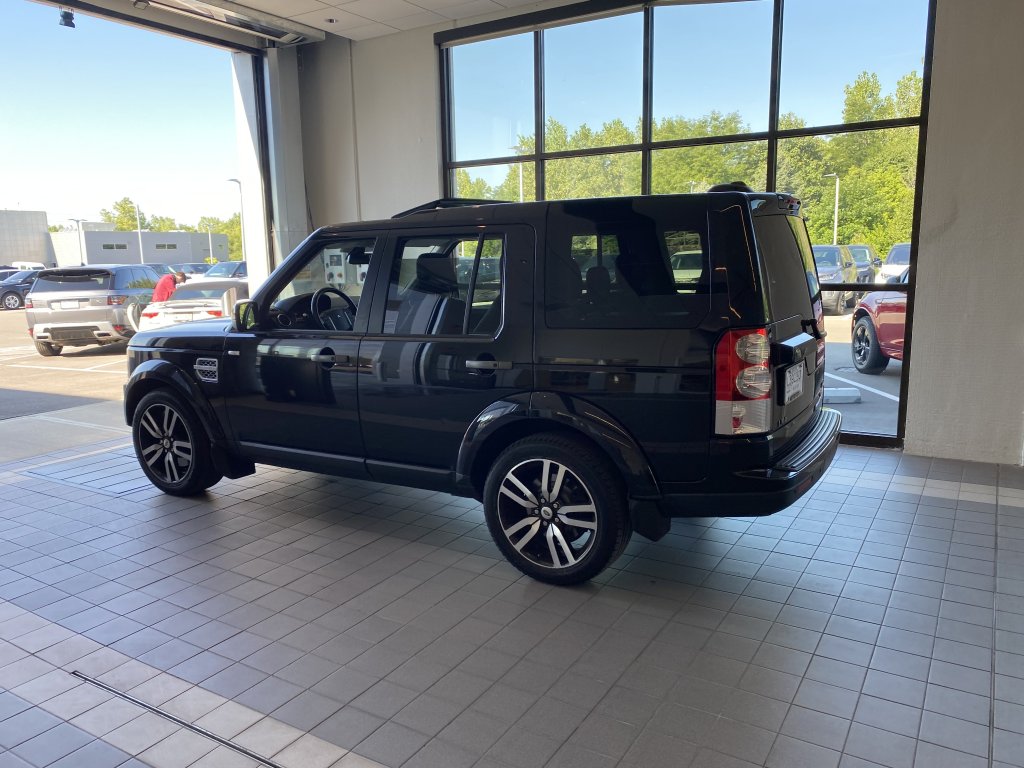

Does this 5.0 sound healthy?

I’m assuming since it was installed by a legitimate shop, they would have looked everything over first, changed filter and fluids though.
I don't think you want to "assume" anything. Contact the shop that did the transmission work for more details. Replacing an LR4 transmission usually involves taking the body off the frame. To go through all that labor and drop in a used transmission with 110K miles on it seems like an intentional shortcut. Knowing a rebuilt transmission was just installed would make me more confident in the purchase over some random transmission. I "assume" owner #3 got rid of the LR4 because he/she knew the transmission was failing.
TrinidadLR4
Nov 27, 2018
487
296
NE Washington DC
As mentioned, the body has to come off the frame in the LR4, it does not drop out like in most cars. This is not your typical auto trans replacement.
Yes it says three owner, the first owner had it for like 7500miles and 10 months , the second owner, had it for like 7k miles and 7500 miles and 1 year and then the last owner had it from 15k miles and 6 years. So shouldn’t I be looking at the length of the last owner. If there had been problems to a horrible degree he would not of kept it right since he owned it for so much of its life? Maybe he kept it for the duration of his auto loan? I’m sure there were no headaches before 15k miles.
It did have the LCAs replaced and A/c comp.
as far as the transmission replacement gos is replacing with a used SUCH an awful thing? I mean I have done it before, and I have also had one rebuilt. Used is definitely cheaper, but I do see y’all a point. I’m assuming since it was installed by a legitimate shop, they would have looked everything over first, changed filter and fluids though.
