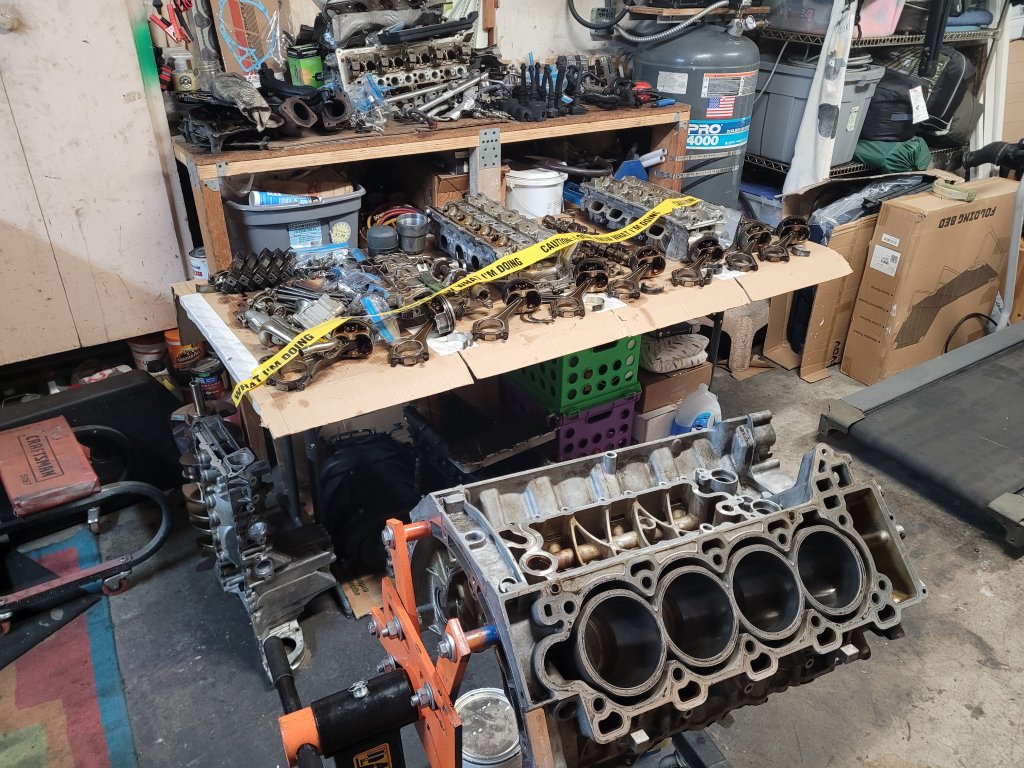

Heads and block are nice and flat. Unfortunately, since rod bearings 1 and 2 spun, it seems to have given the crank nose a bit of wobble. Shop said about .004". I will get another crank and rods, plenty of reman'd and good used ones on ebay. Everything else is cleaning up nicely. I have opened every oil gallery including the oil pump, sump screen, cam screens and restrictors in the heads for cleaning and flushing. I will also disassemble and clean the cam phasers. Looks like not much debris made it past the oil filter. I cleaned up the cam journals with 1200 grit emery cloth. Should I go finer to really polish them back up? They're quite smooth now, just not polished like the lobes.
My wife gave me the caution tape. I warn everyone now.
