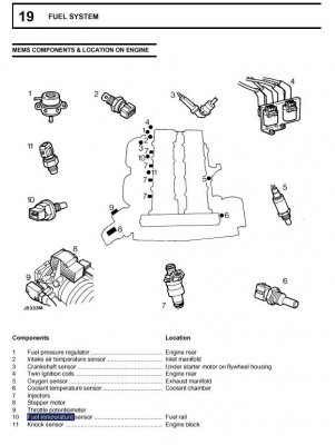

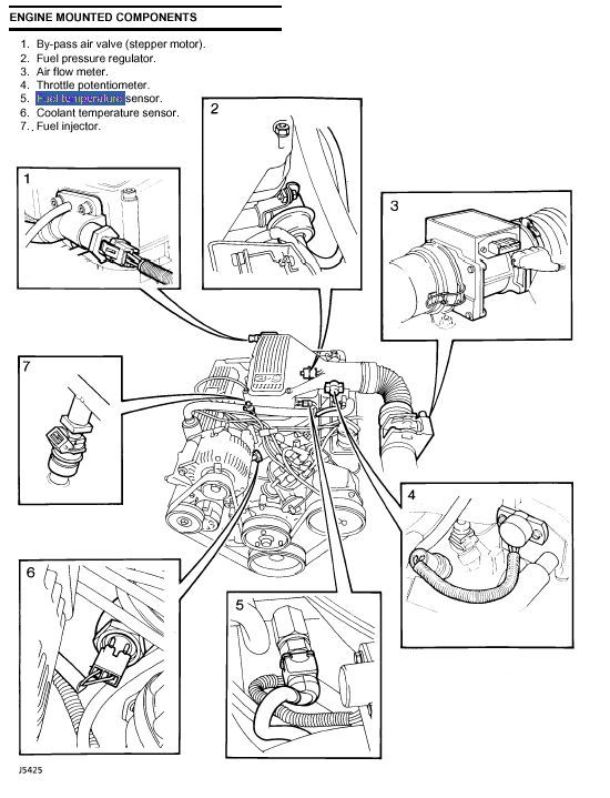

Where is the fuel temp sensor located?

Hope this helps, I think these are the correct pics.

Found it right after I sent the post. Ordered from British Atlantic.
