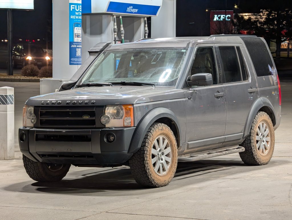

FYI to all who may be curious, I just had a set of the AT4Ws in LT265/65R18 installed this past week. They fit great, and look terrific on my newly powder-coated steelies; wheeled them Saturday with zero issues, but did notice the slightest rub in my driveway in reverse, driver side wheel well at full lock.
One note I didn’t realize about these tires when ordering is while they are LT and 10-ply tread, this size only comes in a 2-ply “HD” sidewall. FWIW I ran them at 17-18 lbs in loose gravel and rocks all afternoon with zero issues.
Also, I’m new here. :) Picked up my 2013 HSE in July (first LR for me) and couldn’t be happier with it. Pics below!

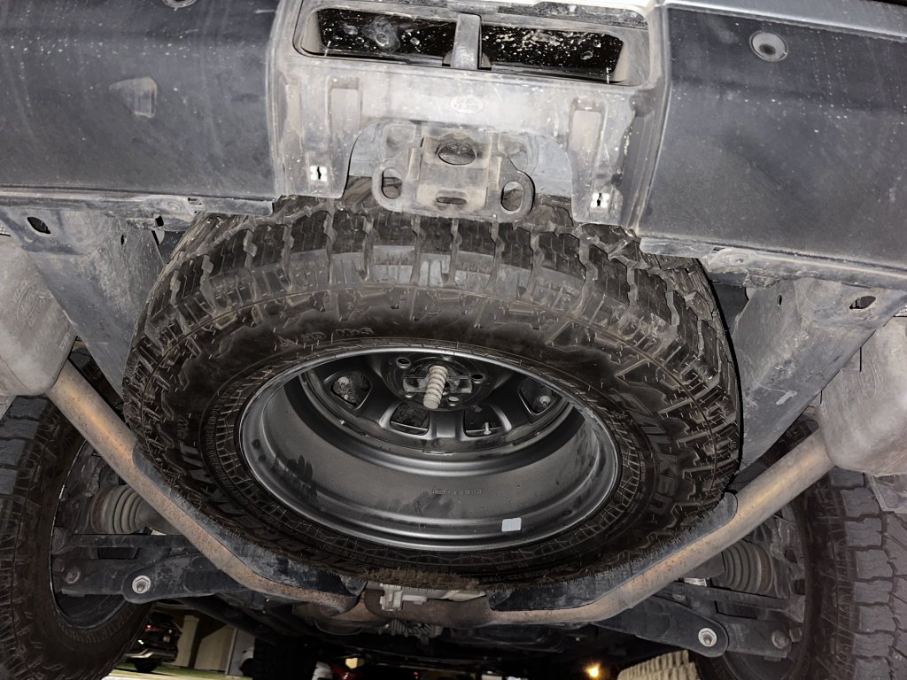

This looks great! Thanks for sharing. Can you test this out at bump stops? I'm curious how close this is to the wheel well pushed all the way down given that the diameter is 31.7". If you have the GAP tool, you can deflate the air from there. Also, were you able to fit this tire in the spare slot underneath?
It does fit in spare slot, albeit with a bit of shoving and almost completely deflated (10 lbs or less). Just received my GAP tool and will test it at bumps sometime this coming week.
Abram
Dec 30, 2024
77
21
Southern California
Oh wow I'm surprised you were able to fit it underneath with the heat shield in place. I had to remove mine to fit the KO2 which by the numbers is slightly smaller (also fully deflated).

I pulled the trigger on the E rated at4w last week. I had a last second invite for a Moab trip, so I got those and installed along with some proud rhino rock sliders. I only really went through fins and things, but it did marvelous there, the sliders didn't even touch anything.
I'm waiting to get a compressor before stuffing the spare under. I did check the room in access height and i can still fit my whole hand between the fender and the tire. I do have an 06 lr3 where the frame horn is pushed back further than the wheel wheel, so no potential rub there.
