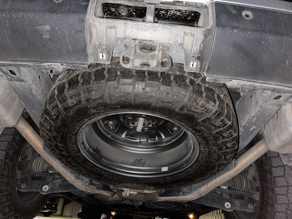

It does fit in spare slot, albeit with a bit of shoving and almost completely deflated (10 lbs or less). Just received my GAP tool and will test it at bumps sometime this coming week.View attachment 25753
Hey, thanks again for the help! I was able to also fit the tire in the spare slot at 10ish psi. Next, I want to see if I can reduce the size of the rubber stoppers above the tire. They're about an inch long, which seems overkill. Shortening that could reduce the risk of dragging the tire on rocks.
Btw, I tested it at the bump stops today and I'm getting absolutely zero rubbing. I can even fit my hand between the wheel and my tire at full turn.
There seems to be quite the variation in clearance by the frame horn. Luckily, the frame horns on my 06 model are recessed past the wheel well, but my buddy's 07 model sticks out about half an inch. There's a chance he'd rub a bit there.

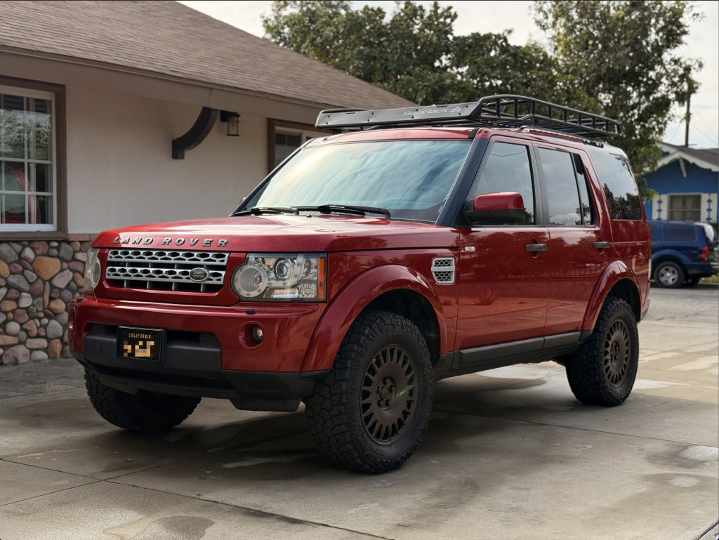

Perfect stance! What wheel offset and tire size do you have here?
Thanks! I did wind up exchanging the tires for KO2s but the size remained the same. I’m running an LT 265/65r18 and the wheels have an ET44 offset which should match OEM spec. I’ve had no issues with them and no clearance problems. Super happy with the setup.

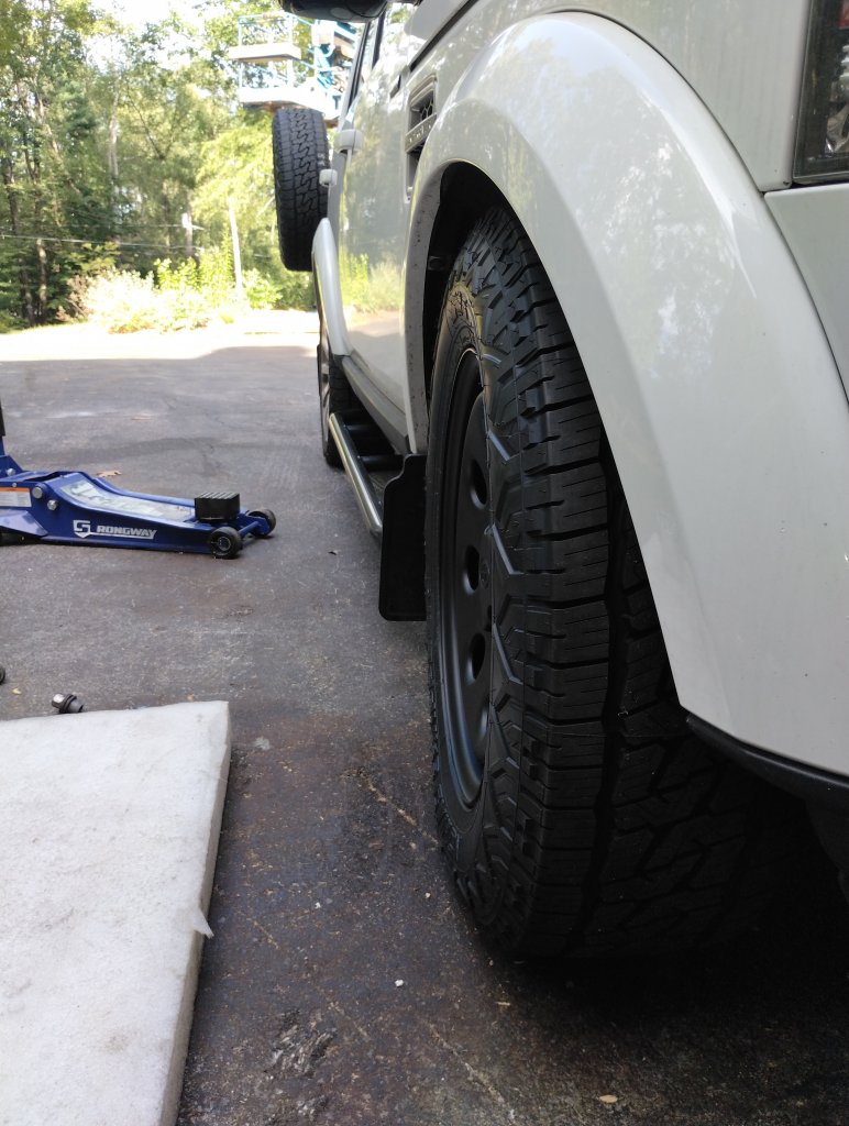

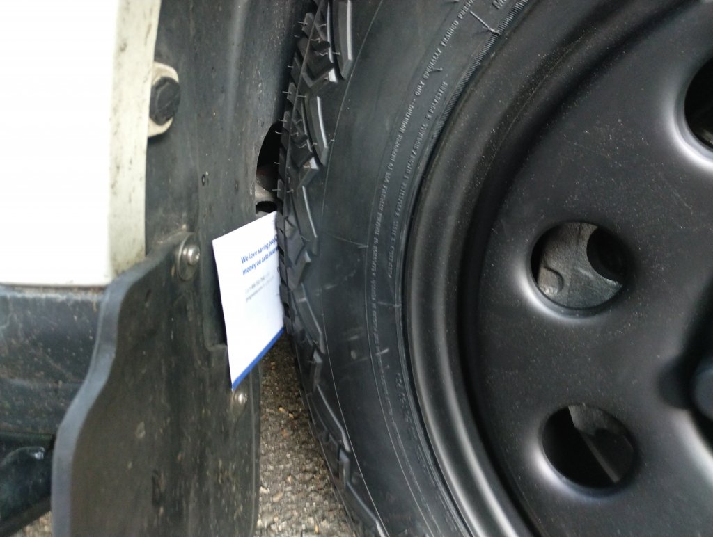

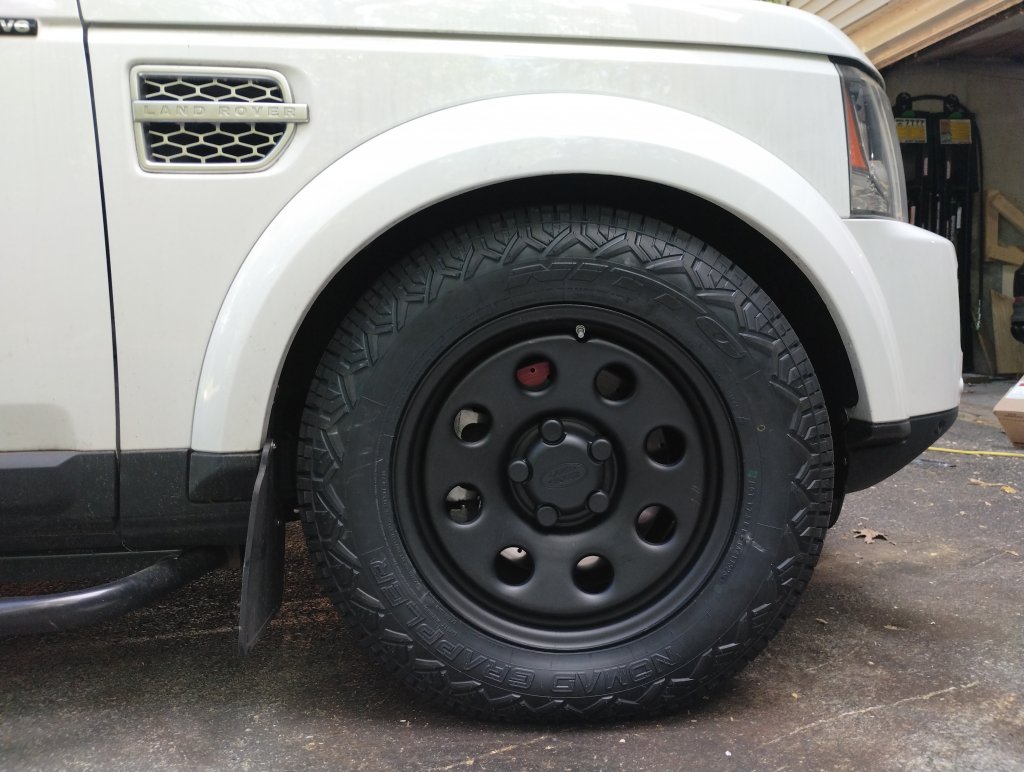

I finally got around to purchasing tires for the 18" steelies I've had in my basement for about 6 months. I preferred not running with spacers so I swapped the LR4 caliper brackets in up front and put some nice EBC pads and rotors in. I debated between 265/65, 265/60 and 255/65. Some people claim there's a little rubbing at access height with 265/65 (31.5" diameter), so I ruled those out. The 255/65 are just a hair smaller at 31" and slightly narrower, so I went with those. At full lock in access height they don't rub, but are very close. I was able to slide some junk mail in-between as a feeler gauge.
Nitto Nomad Grappler 255/65R18 115T XL (2679# @ 50psi).
